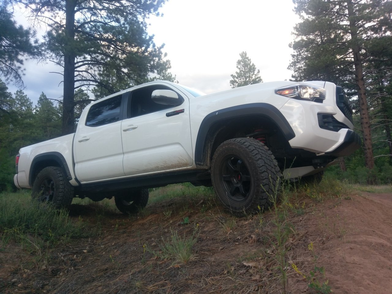

  10. Jul 16, 2017 at 5:19 PM
    #30
    su.b.rat
    su.b.rat broken truck
    Jul 30, 2016
    #193316
    9,869
    yeah i tried it on the same stuff. this is at the turn around up top.
