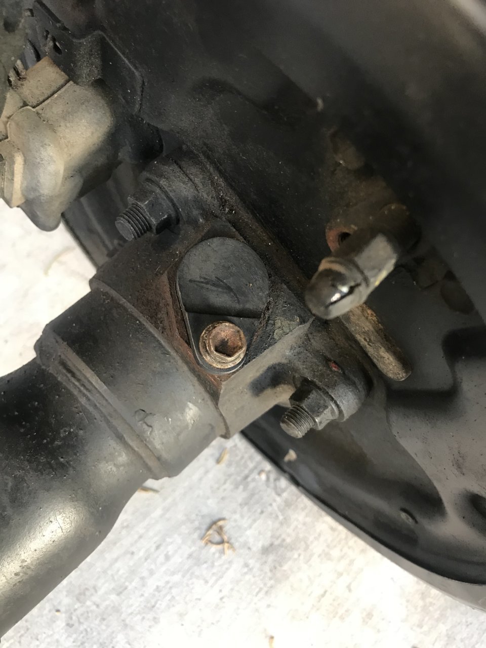

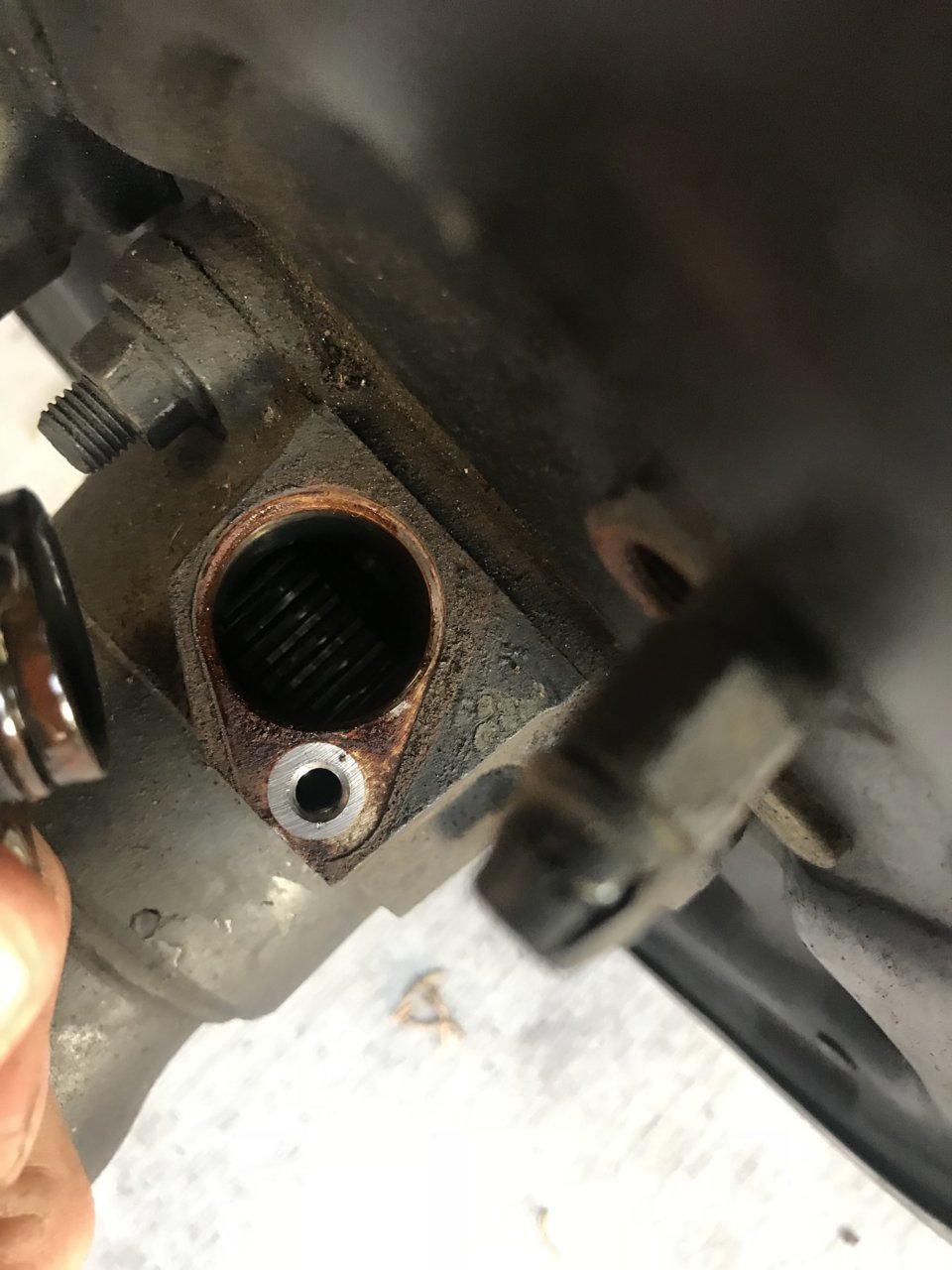

    I read this and had to check. There was caps where the abs sensors would go. I didn’t think that the axles would have the tone rings on them if the truck didn’t come with abs. This might be easier than I thought.CFF4026A-99C2-4C39-8112-C452FE93F209.jpg5A20F250-7FD9-4E55-A70F-8F2FB60E124B.jpg

    That looks like it's wet in there. If that is the case the axle seal is leaking. Just swap the housing 3rd member and everything else to your truck.

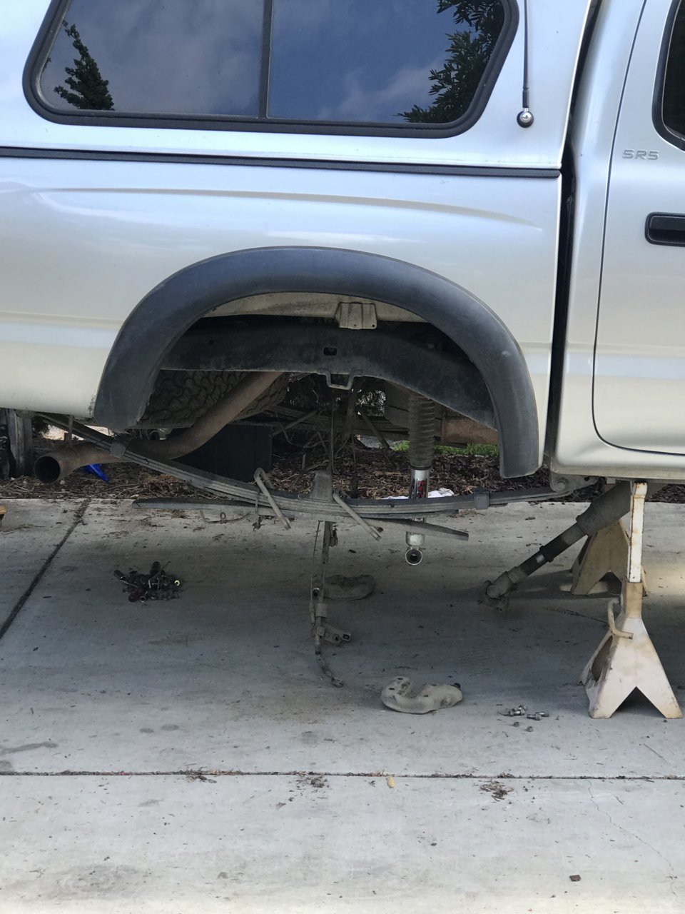

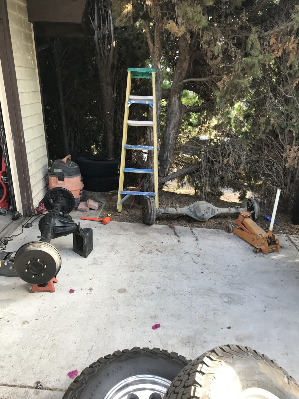

    I ended up replacing the axle seals. Luckily Toyota had them in stock.
    Decided to take off work early today to knock out most of the install. Everything is bolted up and the brakes just needs to be bled once I can grab someone to help. Also, gotta get different e-brake cables and do the wiring up to the dash. Looking forward to a test run on Sunday.DE69A643-9D95-4E17-A67D-A249C1EAD20F.jpgA450CAB5-5E00-4EE5-90D6-98D1ACDF9296.jpgF06C1B66-2218-4770-9737-8FAAF067BCC9.jpg
