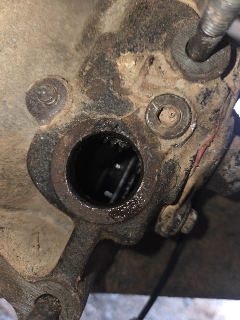

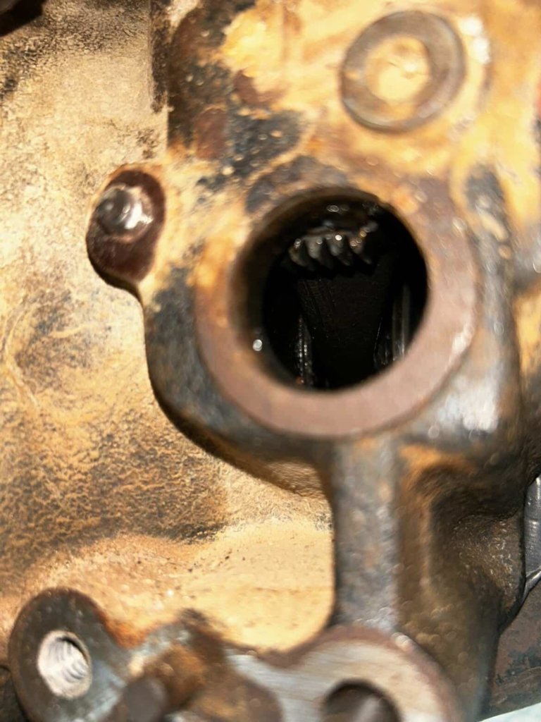

    I think the worn gear sled to the right (engaged) while the actuator is still disengaged.
    Pull the actuator, look in the hole to make sure the teeth is to the right and reinstall the actuator.

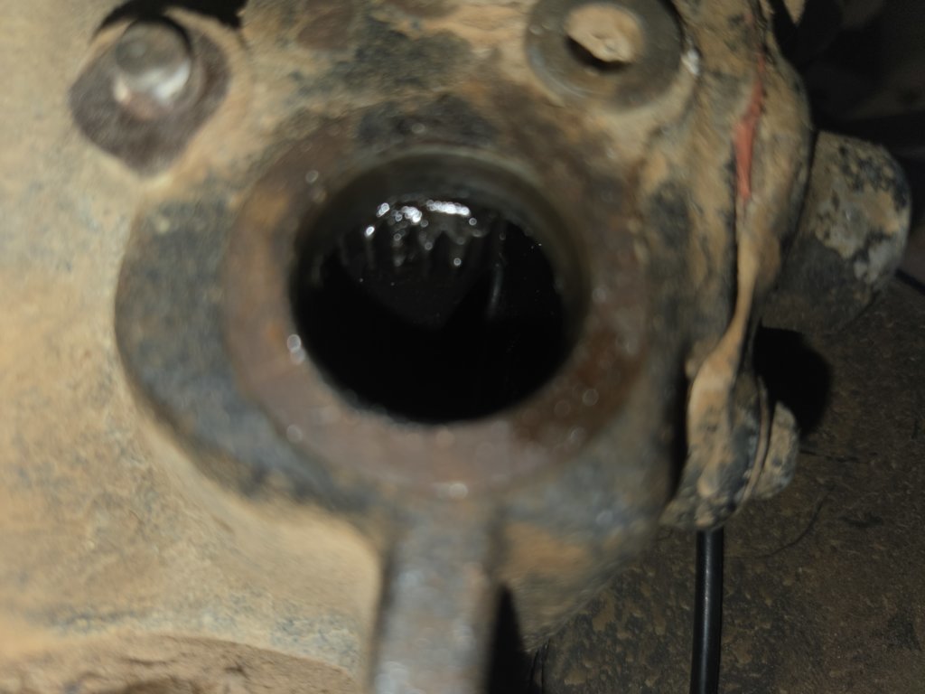

    Btw what is a worn gear? Is it important to me rn? I couldn't find much online

  8. Apr 26, 2025 at 6:23 PM

    toggle it with your finger or a flat head driver. Make sure it’s clocked/position to the right and not on the left side. Left is engage, right is disengage.

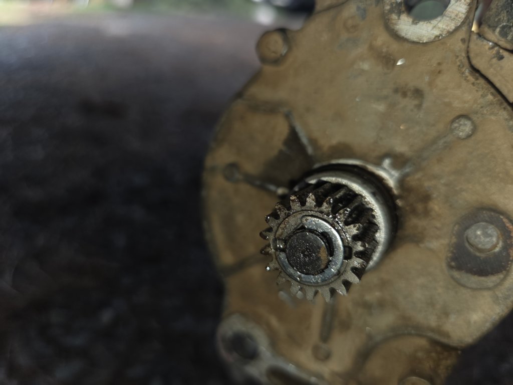

    Do these look okay?
  15. Apr 29, 2025 at 4:14 PM
    TacomaFloppa
    TacomaFloppa [OP] Well-Known Member
    Jan 6, 2025
    #463665
    69
    Looks like its missing some chunks of gear

    Highly doubt the teeth are damaged.
    Pull the actuator and test it. I seen some owners pull the actuator and hold it in their hand while another person pressed the RR button to very of it will spin and depressed the RR button to see if it will rotate the opposite direction.
    Only thing I can think of is the engagement gear wasn’t pushed fully to the right (unlock position) and when you reinstalled the actuator, it was clocked properly. Hence, allowing the unit to lock but unable to unlock.
