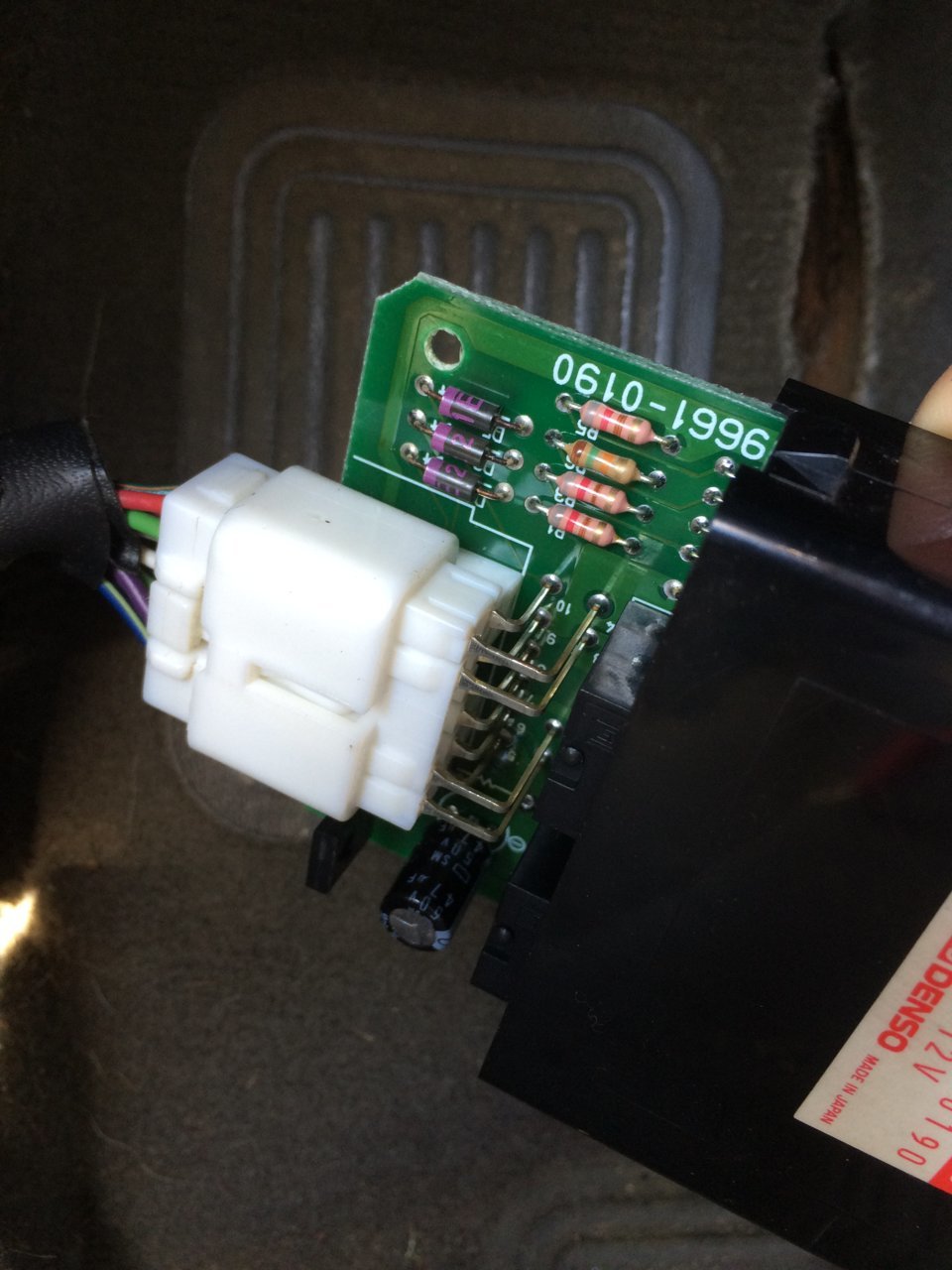

    Just retested switch terminals. There is continuity with switch on, albeit staticky at times. Ohm reading jumping around. I took burnt ECU motherboard and plugged it in and made some readings off the back at pins as they go to board.
    Voltage
    So, key on, with switch off pins 1,5,8 and10 all have 10-12V. The rest have mV readings. With switch on the only thing that changes is pin 4 now has 10-12V reading.

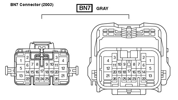

    Can I get a PIN OUT for the BN7 connector? I am making one OEM harness out of two from the salvage yard, one had the wires cut and the other did not have the E-locker, but I need the connectors for the gas pump and the evap canister connections. Also do you have the part numbers for the repair wires and pins for the BN7?

    The 03 diagram has the PIN numbers. Look for the parts labeled BN7 on the wires. There’s a number next to each one that corresponds to the pins. That diagram won’t have all the pins, only the ones related to the elocker. You’d have to reference multiple other diagrams for the other pins.

    I found it, just need to verify the wires colors, it's all there E-Locker, ABS, Fuel Pump, EVAP, Tail Lights!
