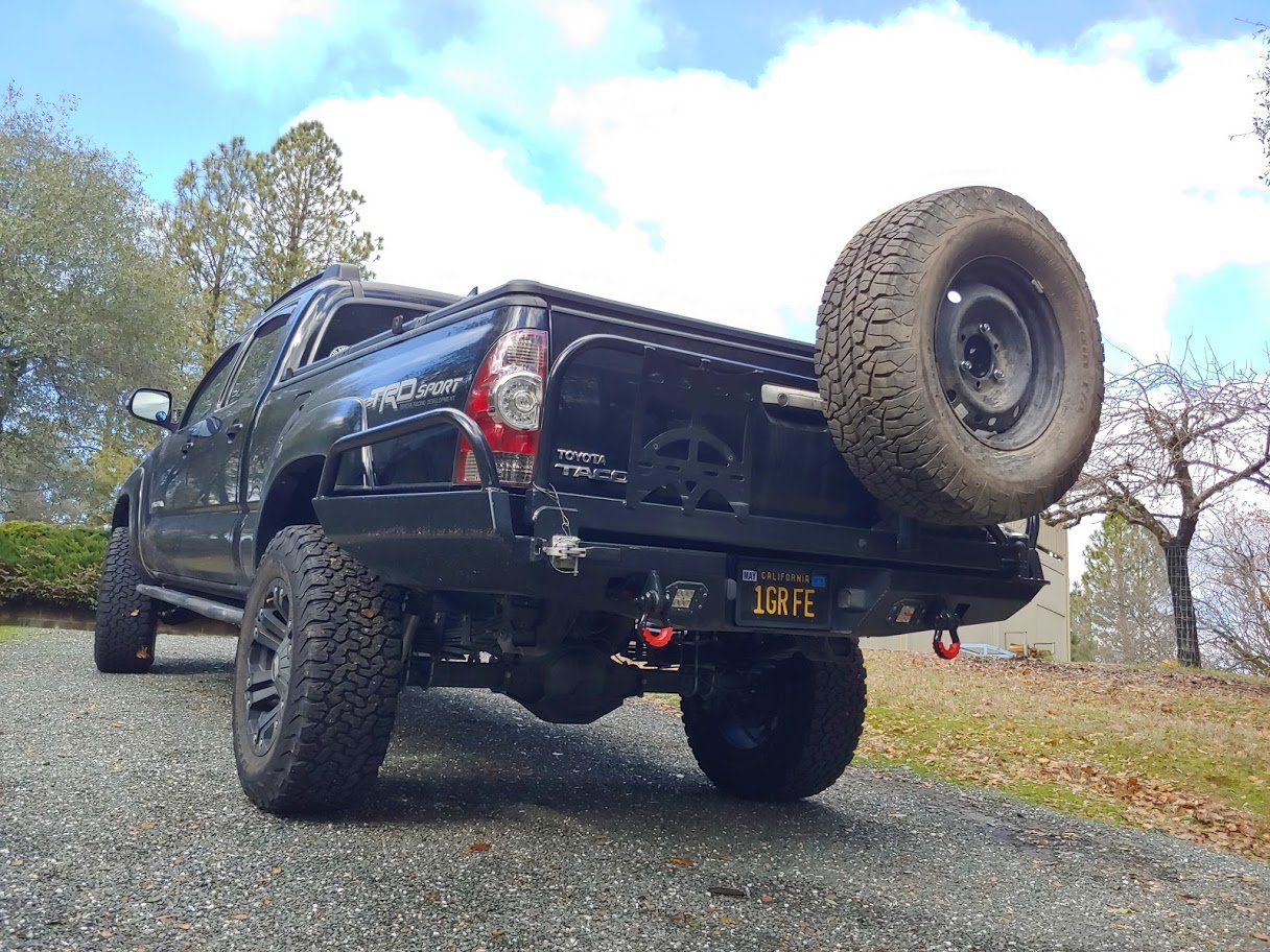

    Yes, I've got 18"s right now; I bought the truck with them, and honestly have had no issues with them at all. I've aired down to 12psi with no problems, and will probably let them go a little lower.
    Here's what I currently have:
    • 4x XD Monster 18" x 9" (not sure of offset or backspacing).
    • 4x 285/65/18 BFG KO2
    • 1x OEM 17" spare wheel from TRD Sport
    • 1x 285/70/17 BFG Rugged Terrain T/A (spare - which will ONLY go on the front if/when I need it)
