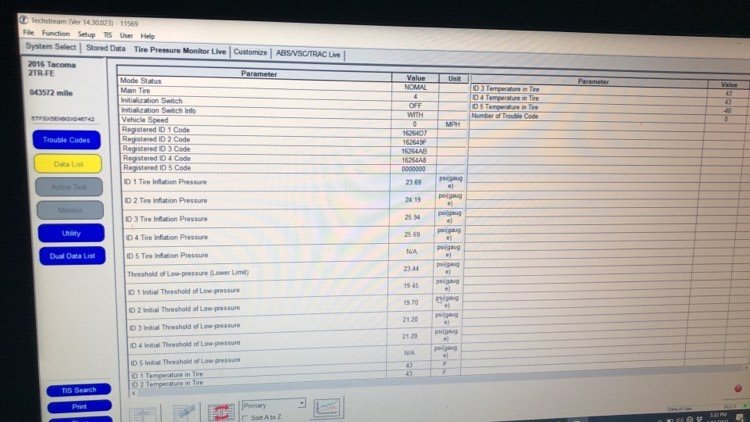

    So i've had my nitto ridge grappler LT285-70-17 e rated for 6 month and toyed with higher pressures. I did't realize the lift shop spec out E tires. But i've been running about 32 and still wasn't as pleased how rough they felt. So i tried the chalk test and it seems 28 is good on the front and looks like i could go lower than 26 in the rear. See the before and after videos here
    My tpms light is on even though the pressure is higher than tech stream. Any ideas? Besides swapping to like C rated. That's the eventual plan later this year unless there's a good solution to keep these.

    May 13, 2020
    #327905
