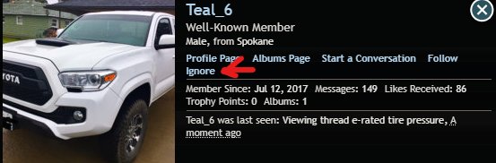

    I recommend the Ignore button. It cleans up the BS in the 3rd Gen section.

    Where’s the ignore button. And yes everyone stop the keyboard warrior fighting. I welcome helpful insites. For the time being I’ve aired my tires up cold to 27 and 26 so when warm they will be 30 and 29. The tpms light is off when cold and it’s in the 30s here

    Click the user name, and it's here:

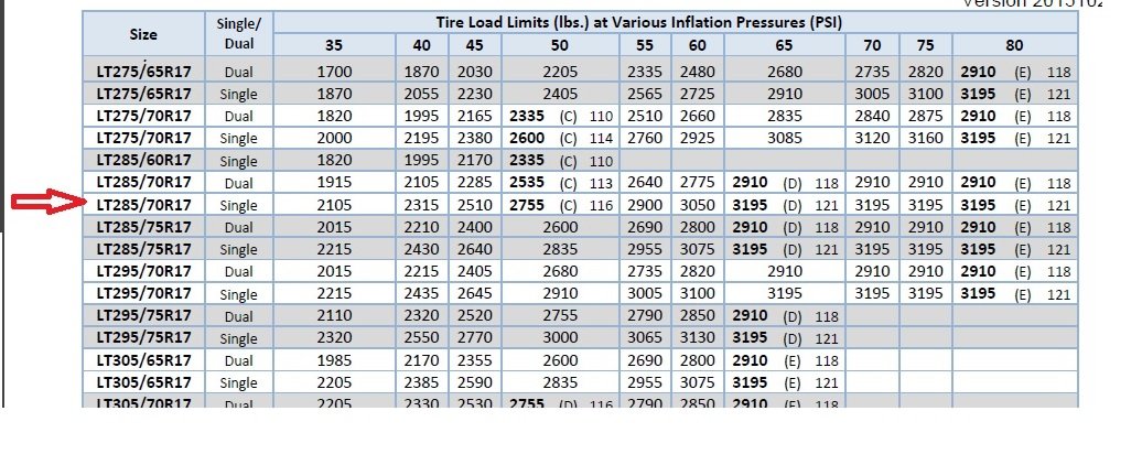

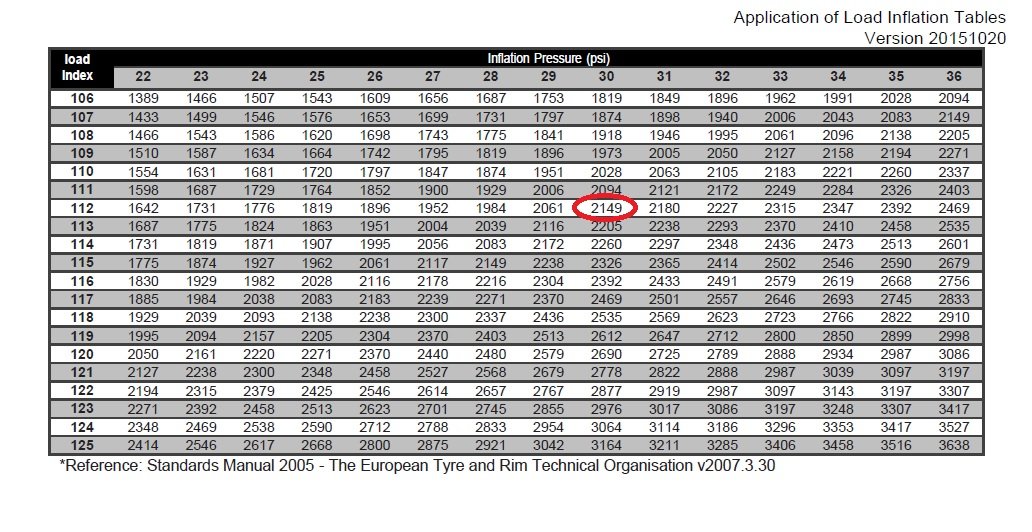

    This is the load chart for your stock tire.
    It's a euro-metric, 265/70/16/112SL.
    At the recommended psi, you have an inflated load capacity of 2,149 lbs.
    P-metric and euro-metric tires are de-rated by a factor of 1.1 for use on trucks and SUVs.
    LTs are not de-rated.
    LTs require (2,149/1.1)=1,954 lbs inflated load capacity.
    This is the chart for a LT285/70/17. You can see 1,954 lbs is "off the chart", but close enough we can extrapolate a value for 1 psi from the 35-40 psi range.
    2,315-2,105=210 lbs
    210 lbs=5 psi
    42 lbs=1 psi
    3 psi backward from 35 psi @ 2,105lbs...
    2,105-(42x3)=1,979 lbs
    32 psi gives you an inflated load capacity of 1,979 lbs
