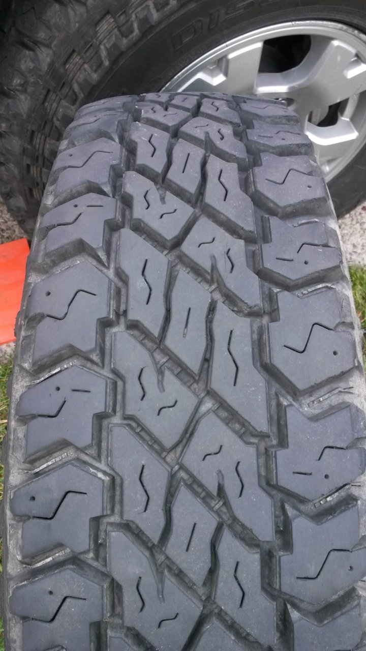

    1,280
    2008 Access Cab 4WD, 2.7L 5 speed
    ST Maxx (load E) with about 22,000 miles on it, always run at 35 PSI on pavement. E is overkill for our trucks but it's all they offer this tire in so I went with it, 10/10 amazing tire if you daily drive and also air down for rocks and other moderate wheeling.
