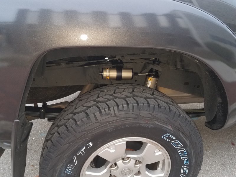

    Here's mine:
    Nedrolls likes this.

    @dcfbftmfw is correct, I was looking for an all terrain tire like I have now, plus the truck looks better with an all terrain. I will look at the Cooper AT3. I wanted a slightly taller tire also, that is why I am opting for the 265/75-16

    I have the Cooper ATP which is essentially the same as the AT3 (just sold exclusively at Discount Tire), and I love it. Wearing fantastically and the tread looks and performs excellent.
    The sidewalls are not nearly as aggressive looking as the KO2s, but that wasn't a problem for me. My previous tire was the Hankook Dynapro ATM RF10 (both in 265/75/16) and it was a pretty good looking tire, similar to the ATP/AT3 but with more aggressive sidewall lugs. I'd consider these an option also, they're both available in C load in that size as far as I know.

    Do you think a 265 75 16 will fit on stock truck with the mudflaps on? I still have the stock dunlops on mine and plan to replace them before next winter. Really like to leave the flaps on, black truck and all. Do they ride nice on the highway?

    Yes, they'll fit.
