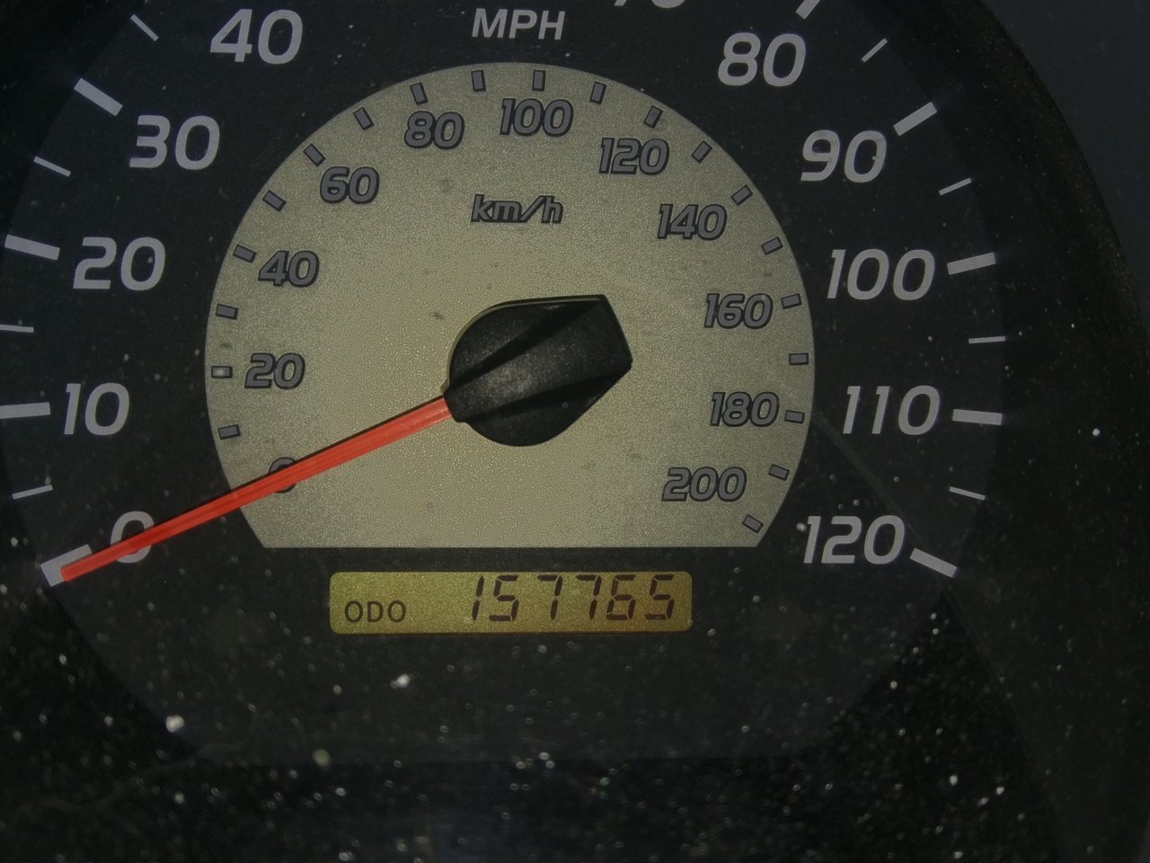

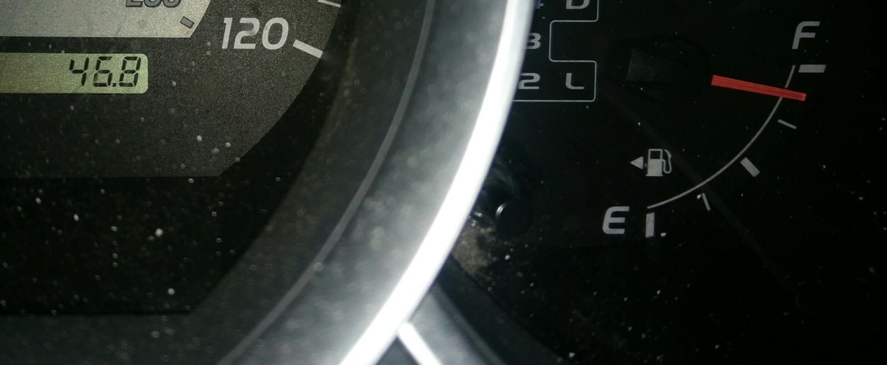

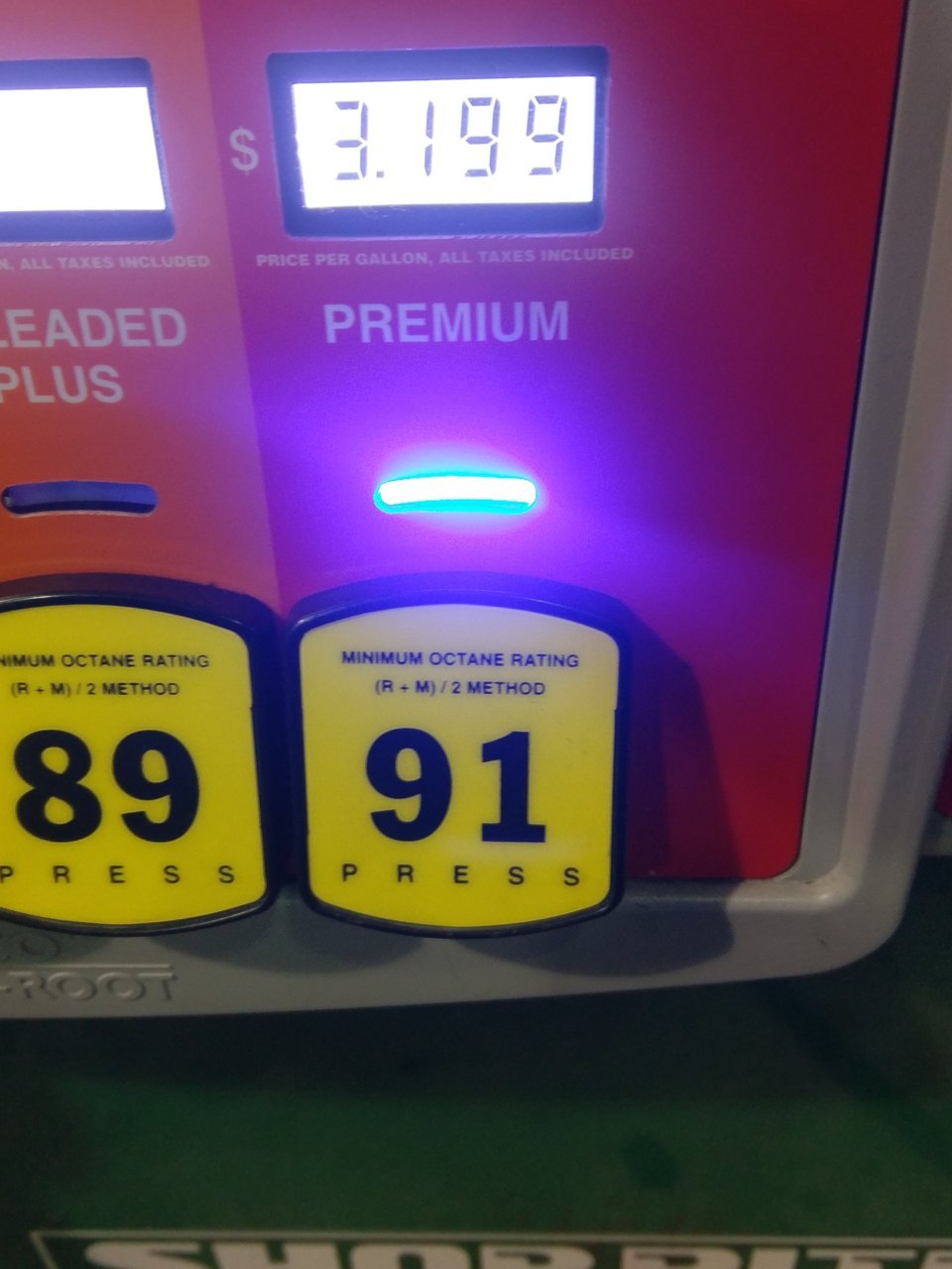

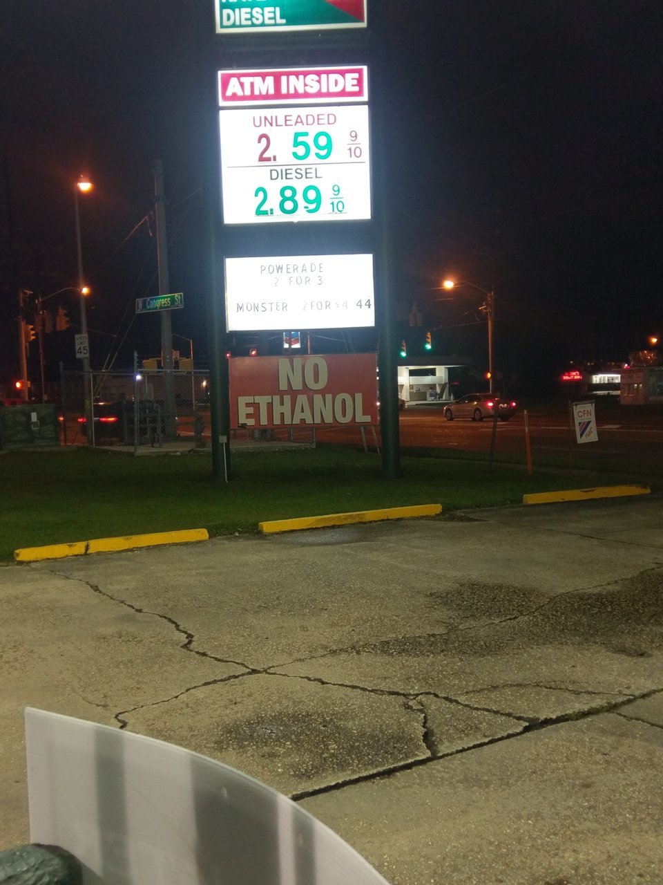

    Ran it pretty low...
    here is statics...
    At the gas station across the street
    10% ethanol 87 octane $2.49
    At this gas station,
    0% ethanol 87 octane $2.59
    0% ethanol 91 octane $3.19
    Right now, going by odometer, I get about 11MPG, (factor in about an additional 14% for larger tires and speedometer being off) so if I'm figuring this right, to be worth the extra $$$ I need to get 14MPG (according to odometer) . If it runs better or any other benefits, I would say an increase to 13MPG would justify the extra cost.
    We will see....

    You won't gain 1 inch of range with the change from 87 to 91 (but you could REDUCE your range), but you could gain by the change from 10% to 0%. That is a $0.10/gallon difference, or 3.86%, which means that you would only have to go from 11 to 11.42 mpg to justify the switch.
    87 and 91 are exactly the same fuel in so far as their energy density. They make the 91 by increasing the concentration of a combustion inhibition additive. Basically, the additive just causes a marginal increase in the temperature at which the fuel ignites so that it doesn't ignite too early in the cycle of an engine that operates at a higher compression ratio.
    There are two broad categories of justification for using "high octane" fuel in a vehicle that doesn't require it;
    1) Some people who don't grasp the physics and have this crazy belief that it must be "better" because it is more expensive,
    2) Sometimes you will come across gas stations that have less (or no) alcohol added to higher octane fuel. In these rare cases, the high octane fuel may actually be better fuel.
