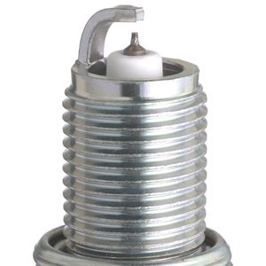

    I replaced the factory ngk's at about 80,000 just thought it would be a good idea since it is 9 years old and still had factory plugs. I replaced them with the ngk ix iridium plugs. Didnt notice any hp gain, but picked up about 1-2 mpg's.:D
    [​IMG] ngk pt# 6341

    So....Any plug would have shown an improvement. The only way to tell is a back to back test. Im guessing the E 3 plugs give less performance then the OEM twin ground plugs.
