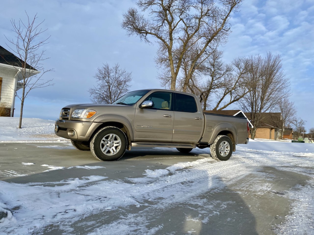

    So I just bought a high mile (285,000) 2006 DC Tundra V8.
    Talking to the guy I bought it from today he mentions how he works with ethanol business folks. Okay, cool. That’s your career choice. Do you.
    Then in passing he says, “yeah E30 is so great, that’s all I’ve been running in all my cars for years! It’s proven to not do any harm and it’s so great!”
    Wait, ALL of your vehicles!?
    I just bought one from you.
    So... I don’t know if “for years” means 5 or 15, but this guy owned my Tundra since new, put almost 285,000 miles on it, and ran E30 presumably the whole time!!
    How screwed is my fuel system? What would you do!?
