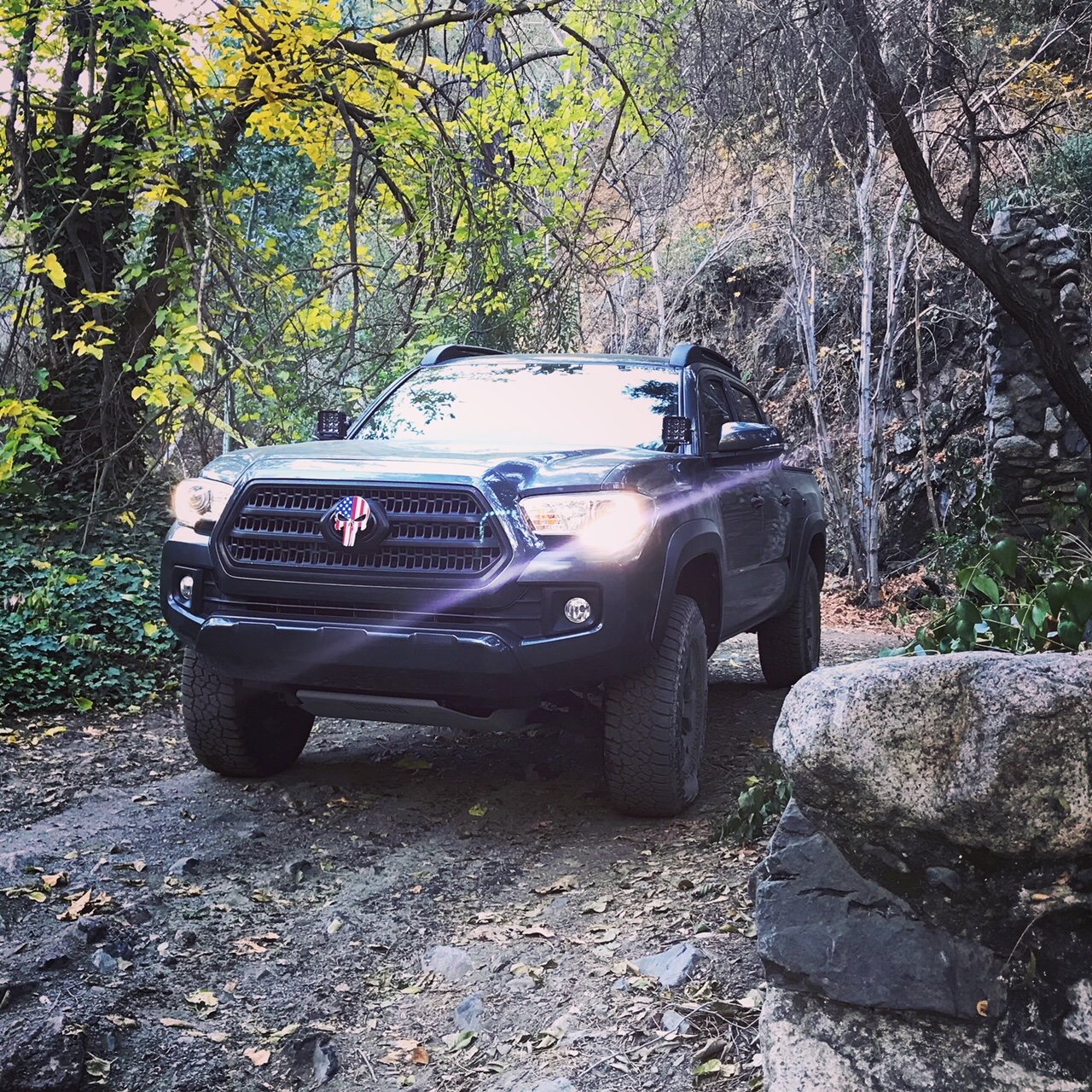

    i ordered my new grill center piece today!! hope to have it soon... heres a pic of my old emblem... the new one will look way better than the last one..

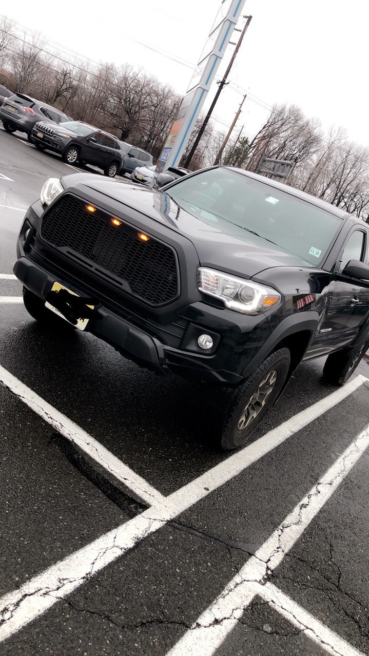

    LordofEnjoyment
    LordofEnjoyment Member
    Feb 6, 2018
    #243657
    20
    Northern NJ
    2017 Toyota Tacoma TRD Off Road
    just ordered it a couple of days ago, thanks for the pics guys! luckily my taco is black so no need to paint!
    also ordered the TRD emblem to put on to it!
    Gunner123 likes this.

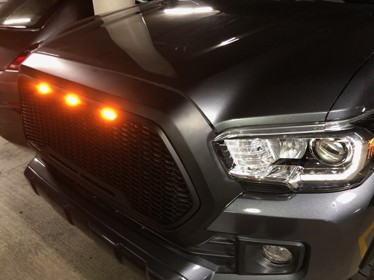

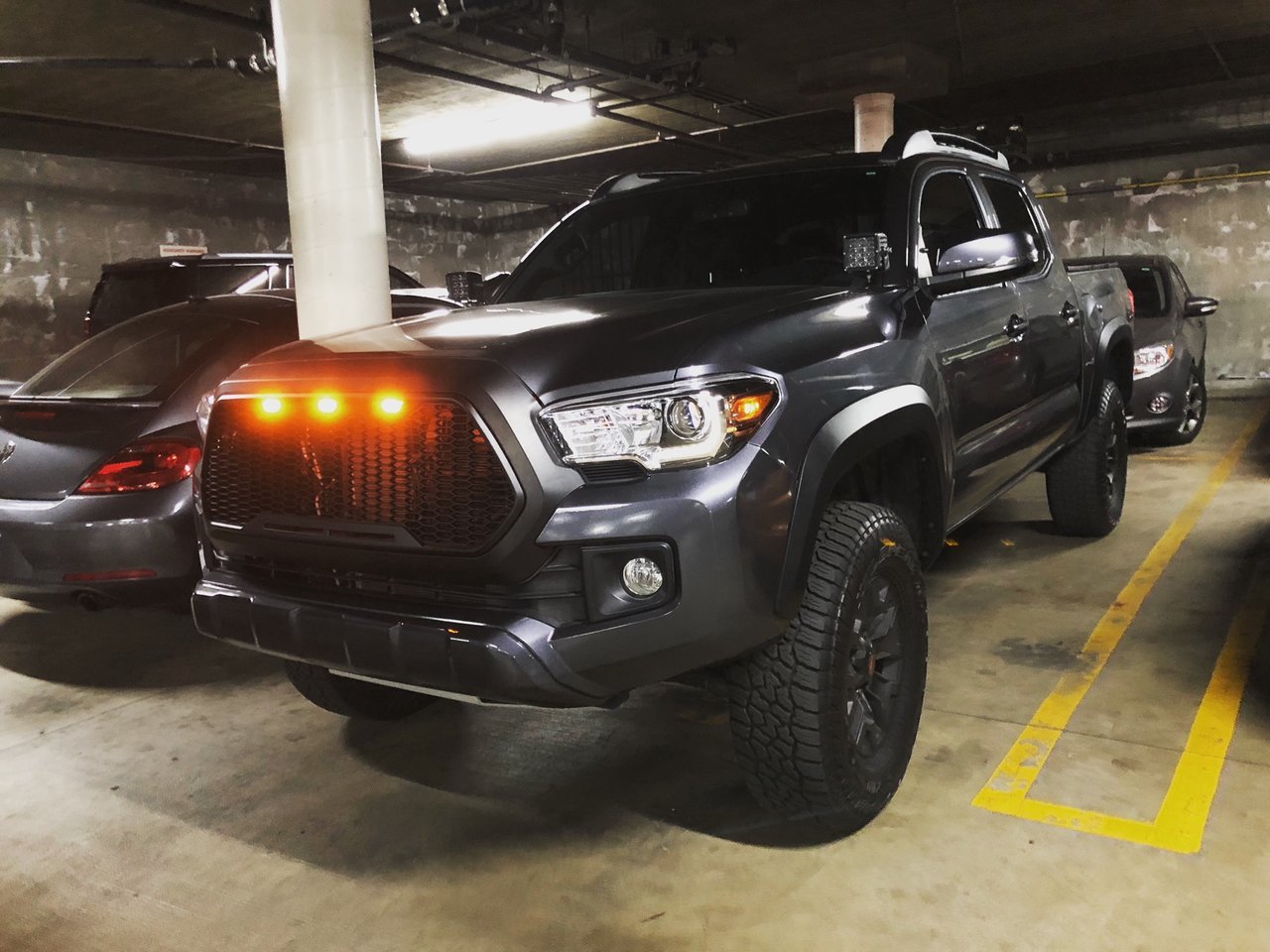

    if anyone is wondering how to wire the amber lights, I just did mine. I wired so that the LEDs would power on as soon as the truck powers (day and night). Pics here

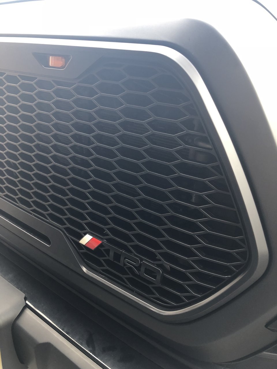

    TRD Badge attached!

    That looks nice. Any chance of a full frontal shot now that it’s installed? I’d love to see another one with the land cruiser “Toyota” on it if someone goes that route.

    Badass, how did you mount the letters?
  19. Feb 27, 2018 at 11:56 AM
    #79
    vuTron
    vuTron Well-Known Member
    Sep 9, 2015
    #163855
    1,120
    SF Bay Area
    2016 Quicksand TRD O/R DCSB AT
    I simply glued them on. The letters came with mounting pegs in the back that I had to remove, in order to make it sit flush to the grille.
