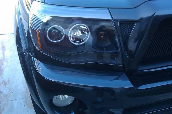

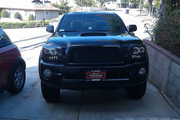

    So I got some new headlights I really like them but I need some help!
    I want to keep my halo's on as running lights, I was wondering if someone knew how to do it. Also when I turn on my lights they make a funny pattern on the wall, I know you can adjust them and I have but what is the best way of adjusting them.
    Below are some pics, two of the headlights and my truck and one showing my funny pattern.
    Please give me input, Thanks!

    yep, light pattern is staying, that's one reason i threw mine away. and i'm confused about your question about keeping the halos on..they look on in the second pic..

    That's because I turned them on with the switch... I would like them to stay on without the switch being on... like the yellow running lights...

    I have the same lights and that's just how the cutoffs are in these projectors. If you want a true straight line cutoff, start thinking HID retros

    not sure how your truck is setup, my running lights only come on with the switch is turned on.. anyway, you could always just connect the wires from the halos to your green wires on your running lights

    I think they are called running lights, I am talking about the yellowish orange lights towards the center of the grill... On my truck those stay on once I turn the lights on... I am not good with electricity so I was hoping someone else did this before... to be quite honest I don't mind turning on the switch while getting in the car...

    oh, yea you have the daytime running lights. we all have to mod our trucks to make ours do what yours does by itself...lucky ass. you'd have to hotwire the halos into the power wires for the running lights, it should be pretty simple

    The headlights will only come on with the switch such as your running/marker lights. Tacomas do not have DTR (daytime running lights). You could try, running a jump wire from your marker lights to just the halo part of your lights or whichever part you want lit with your marker lights. Not sure if it wouold be too much of a load or not. You can play with just running a power jump from one to another and see what happens. Not so sure I recommend it, but you can try. That being said they will still only come on when the switch is on.

    all years, its an option, just a simple relay swap. the DTRL lights up the signals lights not the headlights...surprised you didnt know this if youre around tacomas all day long...
    OP, your going to be stuck w/ that funky cutoff...thats why i always suggest to not get them. the only thing you could do to make it better would be to raise the passenger side to make the cutoff even.
    as far as keeping them lit all the time...tie them into your parking light circuit. thats the best i can think of, they will be lit whenever your parking lights or headlights are on.
