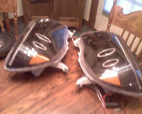

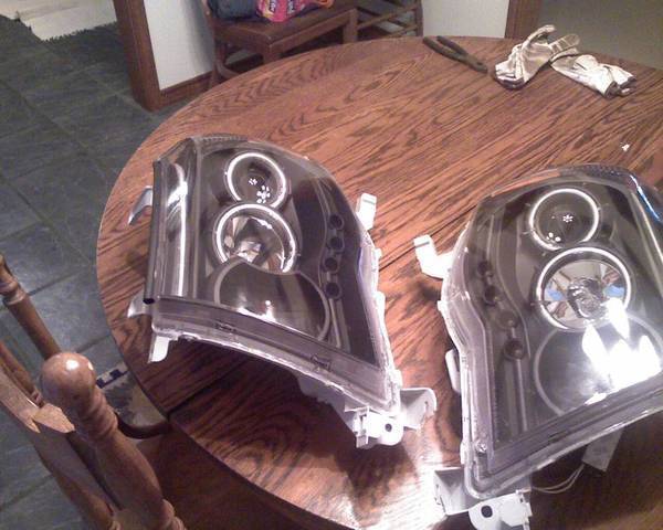

    Ok so tuesday I got my replacement Halo lights. AFTER A MONTH OF NEGOTIATIONS WITH EBAY SELLER!!!
    And I decided I would take matters into my own hands this time. Because I love the way they look compared to all other headlight options.
    I now see why I had fog Problems...
    THESE PEOPLE HALF ASS THE ASSEMBLY!!!
    Their were 1/8th inch gaps in certain spots!
    The whole assembly clips togethor and they use a little bit of what looks like grey liquid nail. But they don't even use that everywhere!!!
    Half a Tube of 100% silicone Clear Caulking and Viola!
    30 Minutes till I can install.
    Hopefully No probs this time. Or I will have to switch to another brand (NO!!!!)
