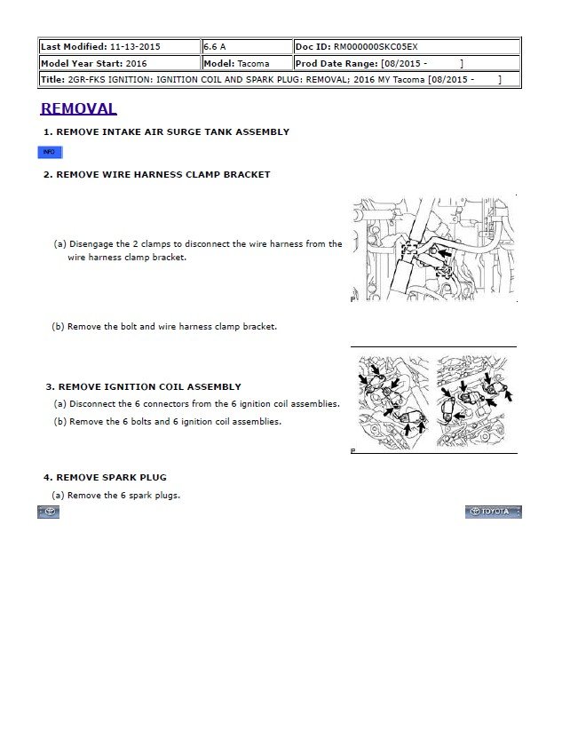

    OK, so it's a good thing the spark plug change interval is not too short (Note step 1):
    IIRC, the passenger side coils don't look too bad.. it's the driver's side that's a bitch.

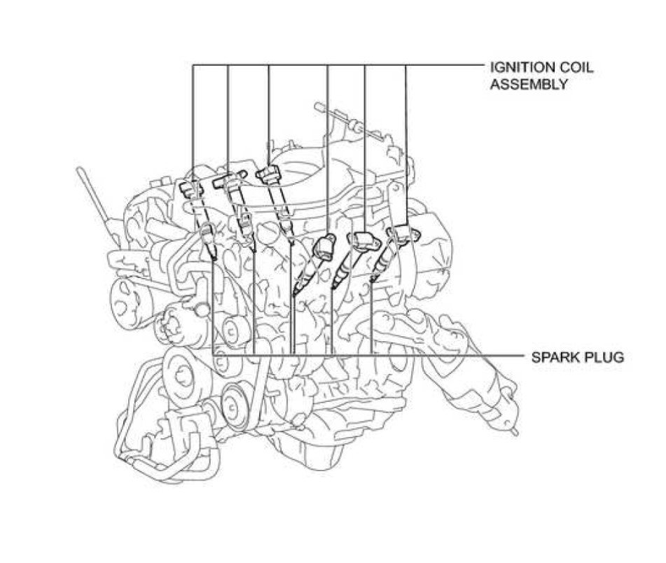

    More clarification on the coils/plugs:
    That f'd up looking curvy thing on top of the engine is the intake air surge tank. Yes, there are gaskets involved, and yes the throttle body bolts to it.

    In laymans terms is that the intake manfold?
    Really doesn't look that horrible.

    The intake manifold is underneath the surge tank. You may be right, but it's surely not something your average guy doing "routine maintenance" is going to try.

    Not trying to scare anyone, but remember when you only had to disconnect the wiring harness, unbolt the coil, pull out the coil/boot and then remove the spark plugs?
    All I'm saying is this is way more work to do a simple job. Not scary. No one is doubting your abilities. Relax. :)

    I ran out to my truck and grabbed the maintenance guide, it has 60k as the change for normal, not under severe, the 4 cylinder gets to go longer. As I mentioned earlier, it was 30k on the old 4.0 so at least we get to go twice as long.

    I'm with you man, if there's a way to get those coil packs out without removing the god damn surge tank I'm in. I've had a cursory look, and on the driver's side there doesn't seem to be a snowballs chance some of them will clear it enough....
