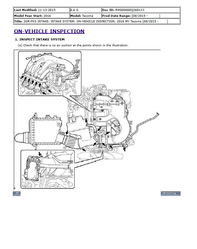

    @AllisFan , here's a top down view of what you see with that top cover off. The driver's side is where things get a bit dicked.

    That isn't bad at all. Reminds me a lot of the upper intake on an old Ford 5.0. 8 bolts +/-, probably some kind of clamp that ties the air filter pipe to the TB, maybe a couple vacuum lines.

    Yeah there's a coolant connection to the throttle body and such, but maybe a fella could shift the whole thing around once it's loose without removing all that stuff.. dunno. More work than I want to do for... plugs lol.

    Process doesn't look that bad. the pain in the ass i taking the coolant connection off the throttle body. I just did that in the fall to clean the throttle body. Only had 15 k on it, but I was just pissing around trying to get a lay of the land and started taking stuff off. Figured while I was there, might as clean the MAF and the throttle body, although the TB didn't need it. I like taking the throttle body off before cleaning it on vehicles that have a throttle body alignment adjuster thingy. Anyway, the coolant connection for some reason was not easy to take off the TB and the baffle underneath it. But overall, the whole process was pretty easy.
