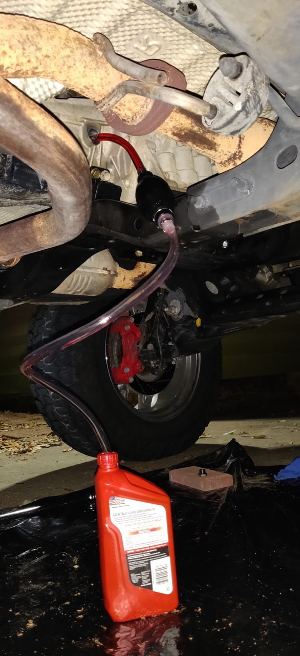

    I always used the pump that screws on to the top of the ATF bottle to fill my trans and it was a royal PITA! Tried this tonight... Much easier! :)
    Best $5 I've spent in a while :)

    I let gravity do all the work! :thumbsup:

    I also gravity feed,very easy and clean.

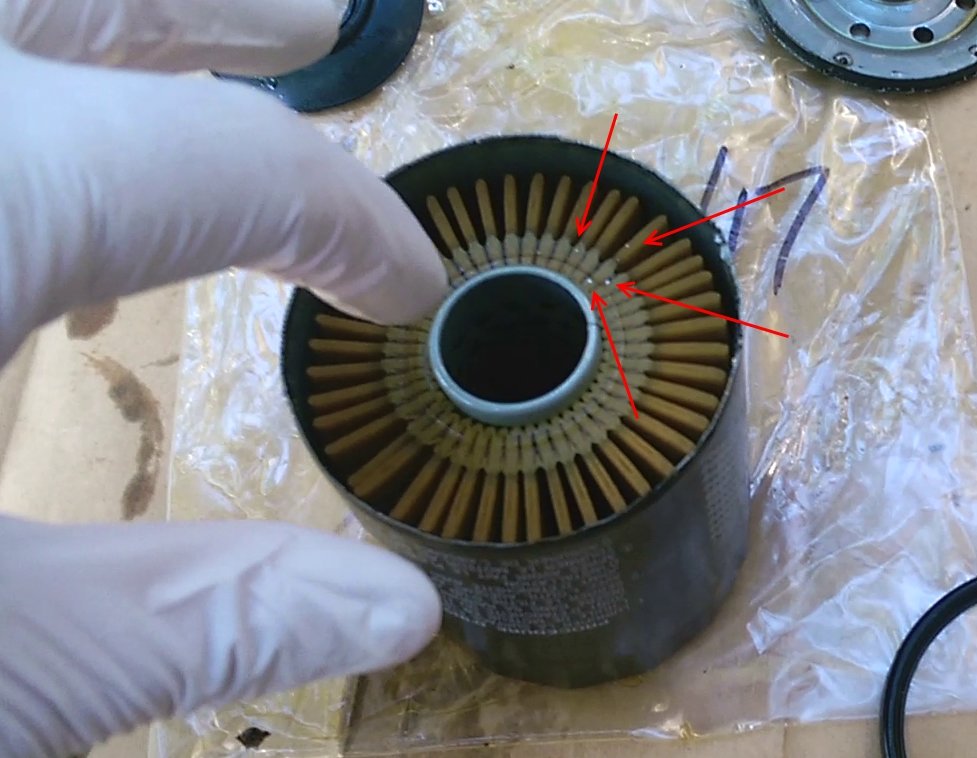

    I'd document that and make the dealership give you a warranty. Your biggest concern is your bearings. Do you still have the oil you drained? Have you changed the oil since this happened? If you still have the oil sift it and look for metal "glitter". If you have not changed the oil since then, get a sample kit from Blackstone and take a sample when you drain the oil and send it off to them to test. Check the rest for metal and also cut the filter open and look for metal flakes. I'll try to dig up some pics of what your looking for when a 1gr-fe gets starved for oil.

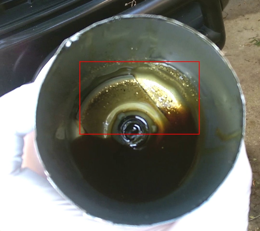

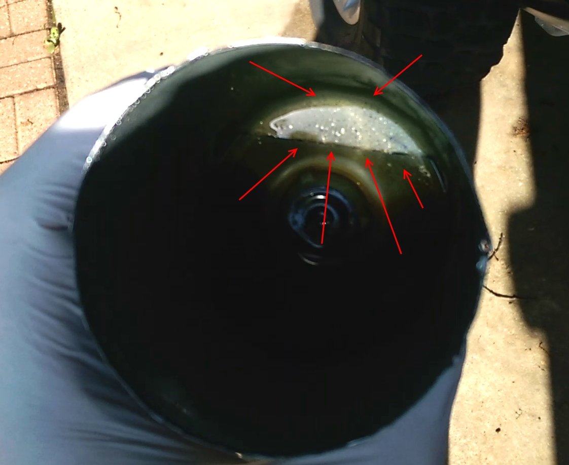

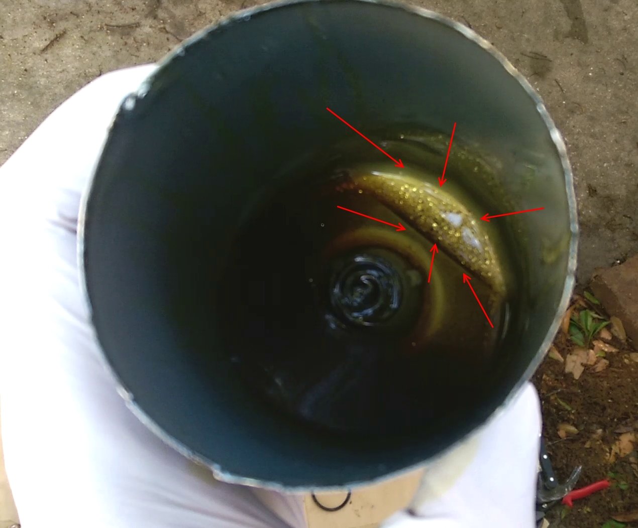

    Short of putting a scope in the cylinders to look for scarring or opening it up to check the bearings about all you can do is drop the lower oil pan and check for metal flakes at the bottom. Here is pics of metal flakes, ("glitter") that got caught in oil filter on 1gr-fe that was starved for oil and damaged the bearings. I have some pics of the metal flakes left in the oil pan even after an oil change, I'll dig those up.

    You mentioned black specs, is it plastic? Where is the clatter noise coming from? Is it coming from the front of the engine? The cam chain tensioner operates on oil pressure, if you had low oil pressure you could have gotten slack in the chain and the chain chewed up the pad on the tensioner which is black plastic. Also listen near the oil pump under the timing cover, if it runs dry you will here it rubbing on the timing cover. If you have aluminum in the oil it's probable shavings from the timing cover.

    Wow this is so smart! Now I don't have to lay on the floor and pump from the bottle when I get to changing my fluid. What size tube did you use?

    The gravity procedure was mentioned as early as 2017 on the DIY ATD thread; see post #741.
    https://www.tacomaworld.com/threads...atic-transmission.68462/page-38#post-15869756
    I used to use a Milescraft pump (still have it); It was operated by a drill and it was very vast. However, the prep time to set up and take down was tedious. I now use the gravity method as well. I use 4 feet of Watts clear tube, 1/2" ID and 5/8" OD; got it at home depot; and the OD is just the right size to keep ATF from draining out.
