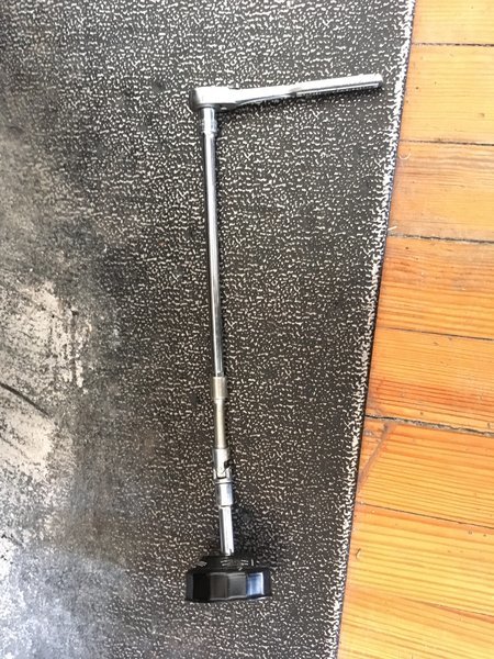

    it's just the one at Wal-Mart. They usually fit 2 diff sizes filter. I don't have a phone that takes pictures so it's kind of an ordeal to post one.
    Will say my ratchet is nice, offset w/ a swivel head but I think the shorty straight works also.

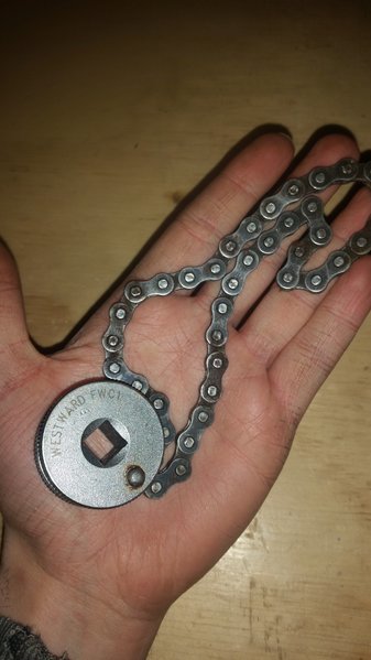

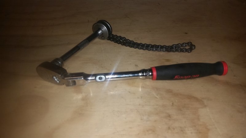

    I'm still trying to figure out how to upload photos but hopefully this works. Here are some pictures of my favorite filter wrench. I am a complete Westward hater and think they mostly make garbage yet this particular tool has been perfect. Its smaller than a new roll of electric tape so it fits in my portable tool box. This thing has uses beyond filters as it can grab onto all sorts of stuff. I think they stopped selling it but if you find one grab it. I've been using this thing lots for about 15 years. I bought lots of westward back then and most of it has failed or been replaced yet this thing goes with me everywhere.

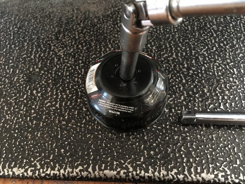

    This one fits the filter I have on the truck now. I have another one for a different size filter.

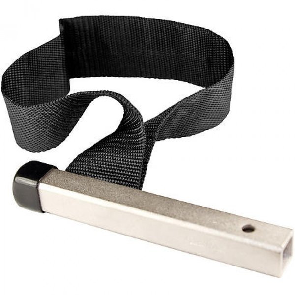

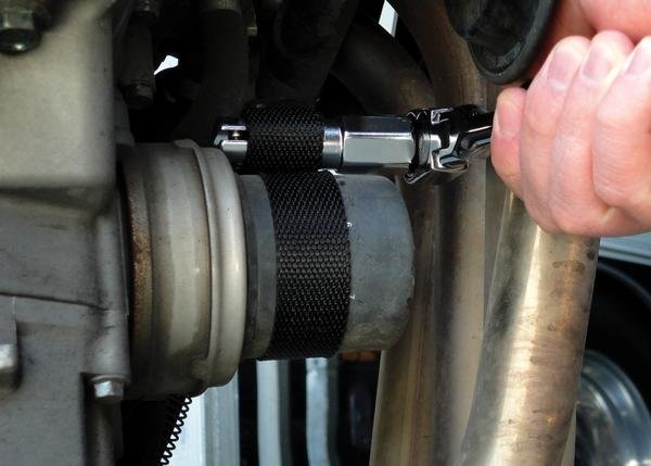

    I have always had good luck with strap wrenches on tough to reach oil filters. Only used once on the taco. NEVER use a tool other than your hand to put on the filter.
    Strap tool looks like this:
    Used like this:
