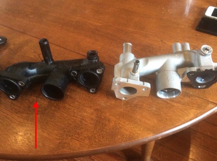

    Topanga Taco
    Topanga Taco BUZZING NITRO
    Jan 6, 2018
    #240465
    2,072
    Rick
    Topanga Strong Southern California
    2018 SR5 4x4 DCSB Harrop rear E-Locker
    The Magic of ALSD RCI-skid RAS-Sumos Bilstein 6112/5100
    A member not too long ago mentioned in another thread he tried a Subaru coolant conditioner that stops head gasket leaks and was successful. It would be interesting to hear from him again.
    As far as that aluminum piece, alls one needs is a mill, TIG, and a dremel with a cut off wheel to make that swap happen IF that Lexus part is a true fit at the flanges. Everything else can be manipulated/added.

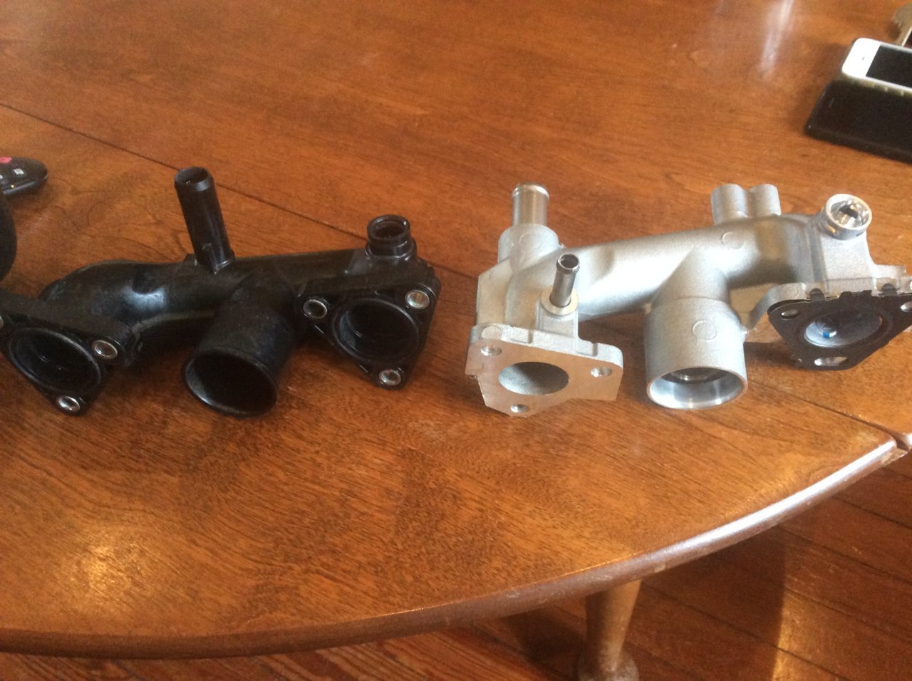

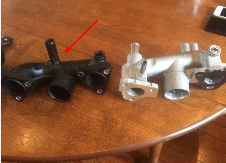

  13. Mar 28, 2024 at 8:26 AM
    #33
    TRD493
    TRD493 Well-Known Member
    Dec 27, 2015
    #173269
    1,723
    Dave
    Texas (DFW)
    17 TRD Sport DCLB 4x4 / 01 4x4 V6 Extra Cab TRD SR5
    This is mentioned at some point in the other thread I was mentioning, it's not an exact match and would have to be altered to work correctly. From all I have read, nobody has used it yet.

    Topanga Taco
    Jan 6, 2018
    #240465
    2,072
    Rick
    The only issue I see is this. But that can easily be found at a scrap yard. It doesn’t matter what it comes off of, just as long as it’s a match. Hell, McMaster might have something to match. I’m sure there are other sources for the perfect fit.
    Done.

    #35
    Topanga Taco
    Jan 6, 2018
    #240465
    2,072
    Rick
    This might be it. The Tacoma’s looks a bit more separated. But, that can be manipulated also.
