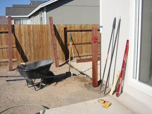

    I love the concept. Just replaced 2 fence posts last week for the first time. I didn't even know this thing existed until then:
