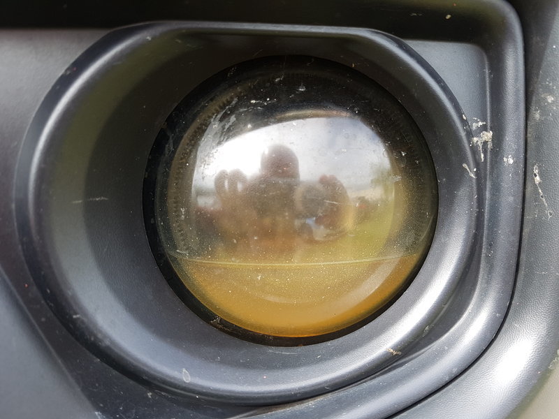

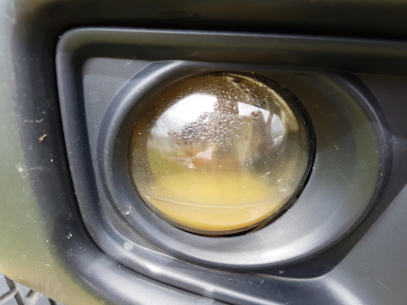

    Easy install, but shitty product. Bought these exact ones but from Amazon.com, had them less than a year and they look like this. Strictly from rainy days, never drove through deep puddles.

    Looks like old beer/piss/bong water.
