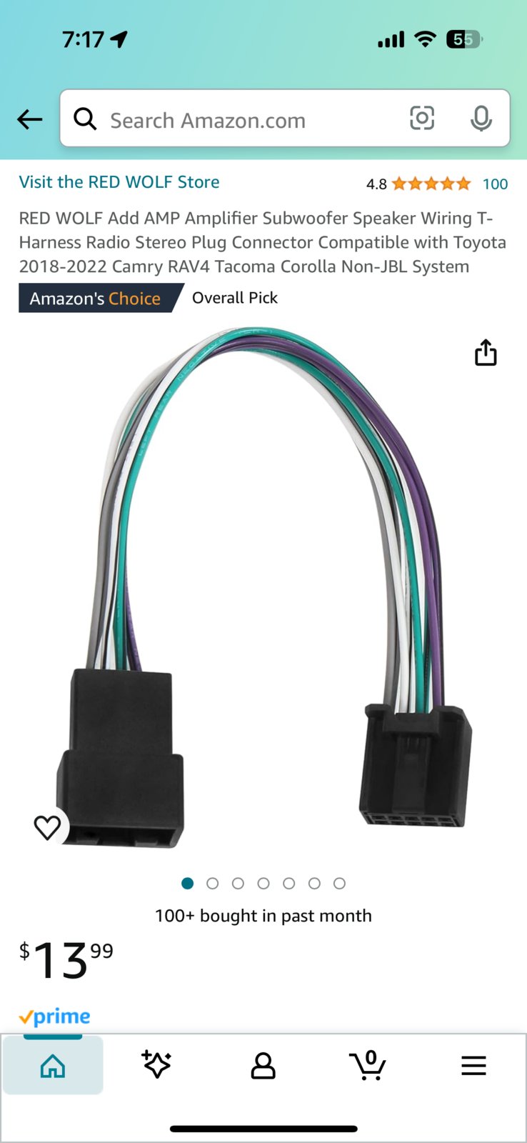

    You’ll want this harness to about any cutting or splicing of factory wiring.

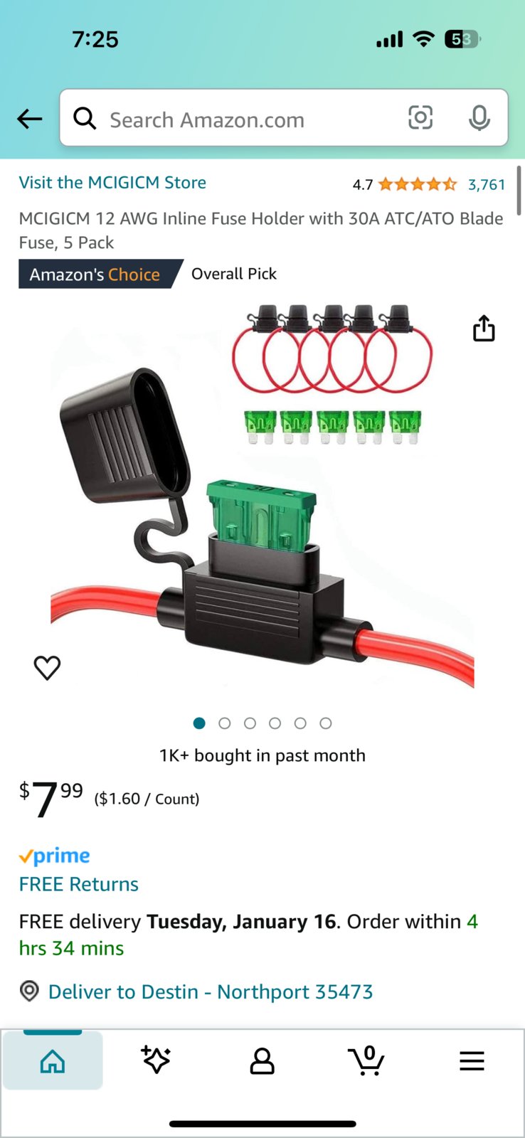

    You can also get constant power from the amp’s connection. These are handy for that. Just be sure to replace with the correct size fuse.
