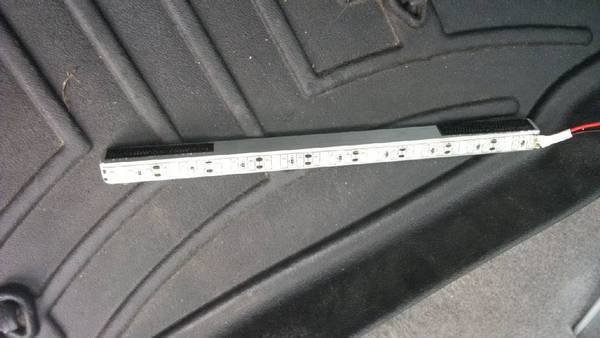

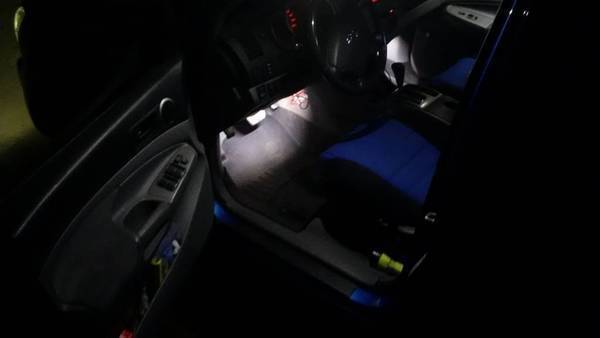

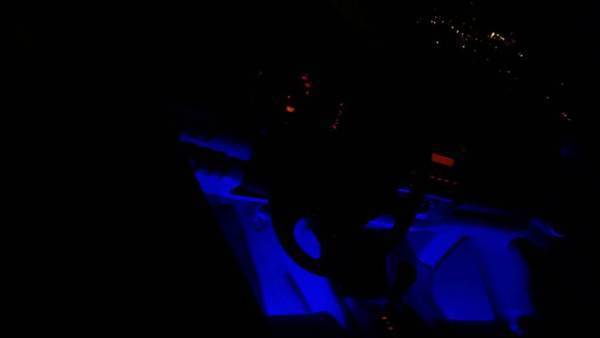

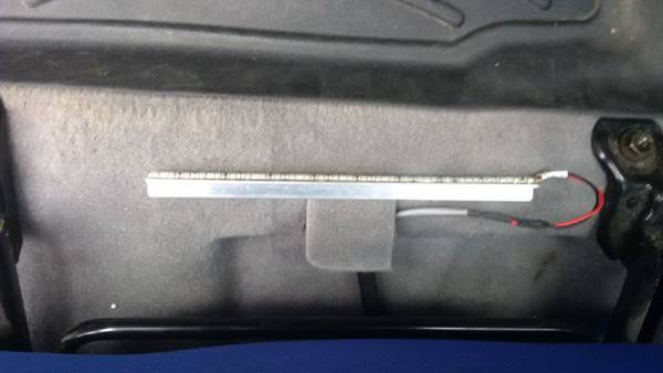

    Added courtesy light to shine outside of door, not just a puddle light but so i can read a document/map outside my doors.
    LED pods i used.
    - connected to dome light circuit along w/ footwell lighting attached under dash.
    on the interior, I fastened LED strips to a short piece of aluminum 1/2" angle. The aluminum length spans the two humps in the floor right under the front of the seat.
    -added the coarse loop side of velcro to the aluminum. The loop part of the velcro sticks to the truck's carpet. Wire runs under the carpet, into the center console area and connects to the illumination wires for the Auto transmission selector. These LEDs are then controlled by the dash dimmer. (Must connect both +, and - from the LED strips to the illumination circuit wires. Do not ground the - end of the LEDs)
    resulting bling. the light does not glow upwards past the console.

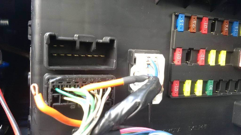

    Can't see well in your pic, which wire did you jump into for the negative door ground(9)? Blue, light blue, blue with white stripe?

    Connection is the same as described in the posts above, the - connection is to pin 9, happens to be a blue color on the 2005 tacoma.

    Ok, I'll just have to go and look since I'm not sure how to tell what pin is what number. Also, is it bad to have too many grounds in one place when using LEDs or anything I guess?

    "...tell which pin is what number."
    see post#2 of this thread.
    http://www.tacomaworld.com/forum/2n...st-place-tap-dome-light-wire.html#post7752254
    " Also, is it bad to have too many grounds in one place when using LEDs or anything I guess"
    Yes, it can be, but its not much of a concern with the LEDs. By replacing stock bulbs with LEDs for your dome light and map lights you are actually reducing the load, so adding LEDs is not too much of a concern.
    The ground is controlled by the dome light dimming circuit which also turns off your dome lights if you leave your door open for too long of a period. This 'ground' or more properly negative side of your LED connections is the described blue wire on pin 9.

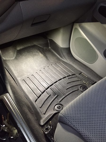

    Truck isn't very clean but here are two of the 6 LED VLED Striplights in 5k white. Pretty bright and it matches the rest of my interior leds. Thanks @.jake your diagram / photo was very helpful.
    I used 3M t-taps. Not a huge fan of them but space was tight. Normally I would cut the wire and use a step down butt connector w/shrink ends.
