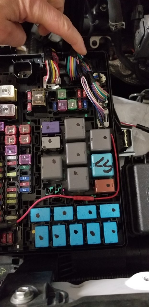

  11. Nov 23, 2019 at 2:10 PM
    OMGitsme
    OMGitsme Well-Known Member
    Feb 8, 2019
    #282305
    2,401
    Sold
    Under the hood. Box went together fine.IMG_20191123_170651.jpg IMG_20191123_170722.jpg

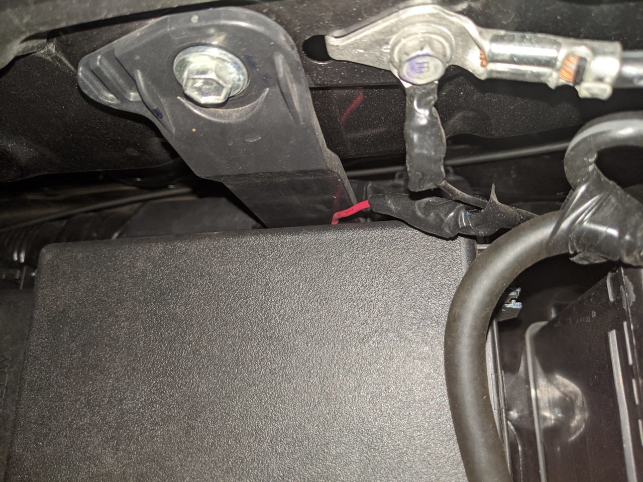

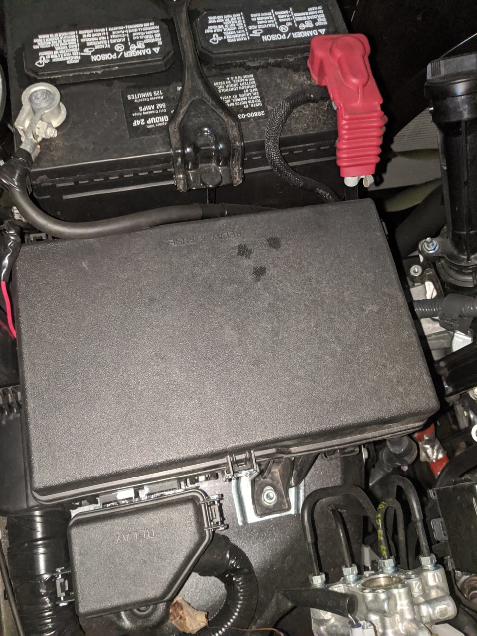

  12. Nov 23, 2019 at 2:11 PM
    OMGitsme
    Feb 8, 2019
    #282305
    2,401
    Sold
    Not on mine under the hood
  13. Nov 23, 2019 at 2:21 PM
    PhenixFord
    PhenixFord Well-Known Member
    Aug 1, 2019
    #300917
    1,215
    Randy
    Arkansas
    2019 MGM SR5 4WD DCSB
    Did you have to cut / notch the cover for wire egress?
  14. Nov 23, 2019 at 3:50 PM
    OMGitsme
    Feb 8, 2019
    #282305
    2,401
    Sold
    Not at all. It snapped right together.
