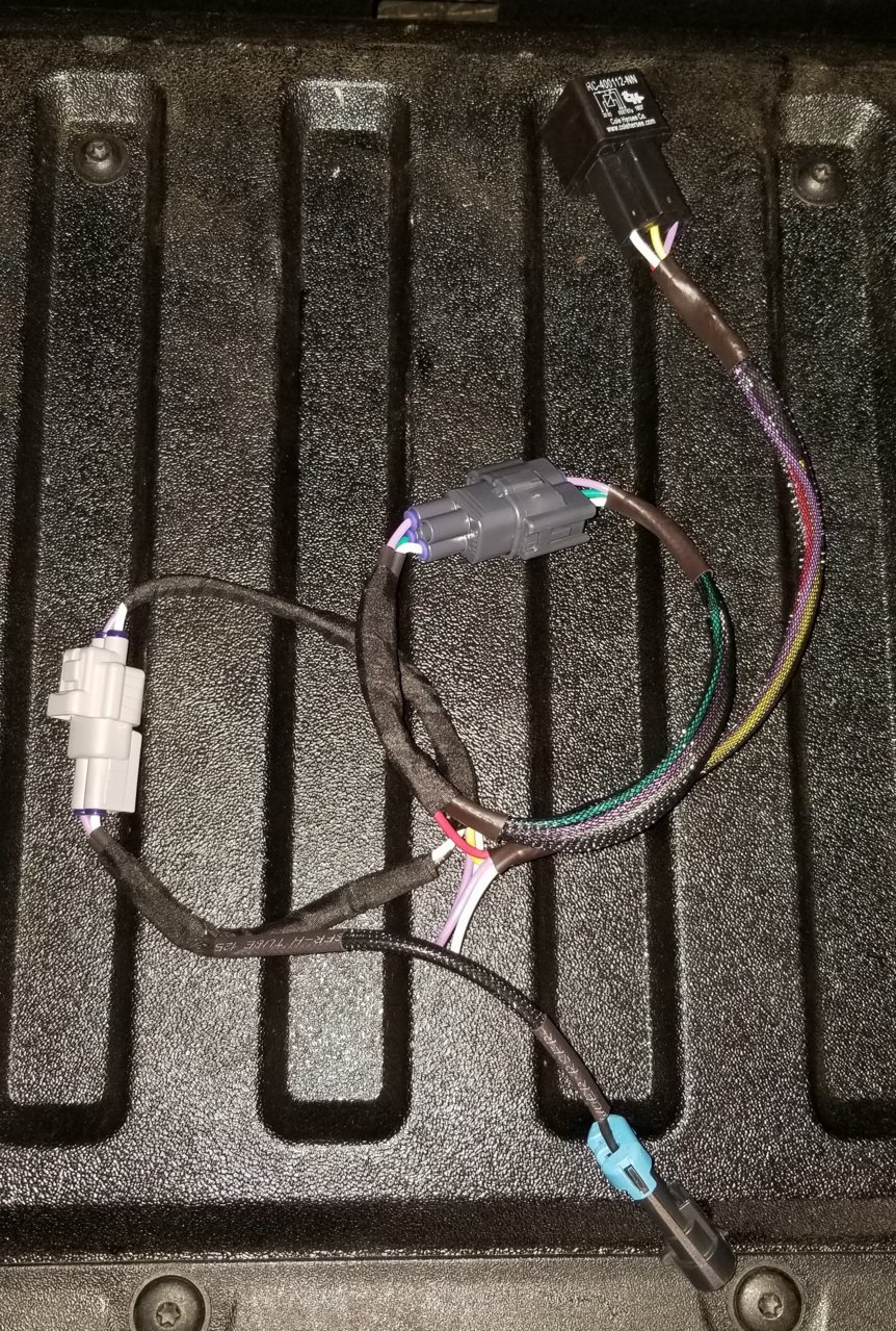

    What are you using the 40 amp relay for in this circuit?

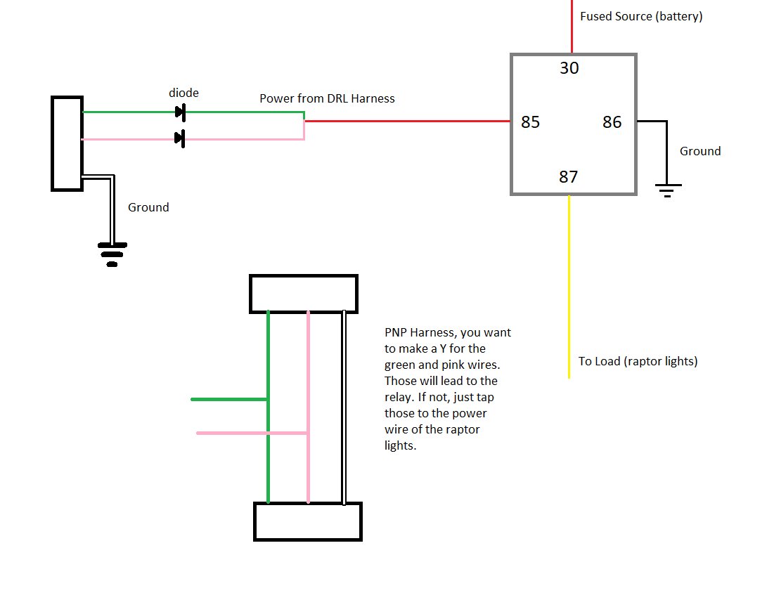

    I don't have raptor lights, I used the PNP harness for something else. I chose the 18-16 AWG (090II-PIN2) although you might be able to get away with the smaller one and 090II-SL1 for the insulation size. As for wiring up your raptor lights not sure how you want to run them but I believe the power wires are the pink and green? I cannot remember the colors. One wire is powered when you have DRL on and Parking brake off and the other wire (pink?) is powered when you have your headlights on. If you want to go the relay route here is a little diagram, not sure if it is correct but this is how I would've wired it up and have for multiple other lights on my truck. You will need a crimping tool of some sort for the terminals/pins on the connector.
    EDIT: Re-did the diagram to include diodes:

    Pink is Tail/Parking, Green DRL's.
    Joining the wires you'll feed the Tail circuit when DRL's are ON.
    And when Low beams are ON -DRL (bright are OFF, and powered by Tail (dim), but since they are tied in your drawing DRL will have a dual input. (not good for the led array.)
