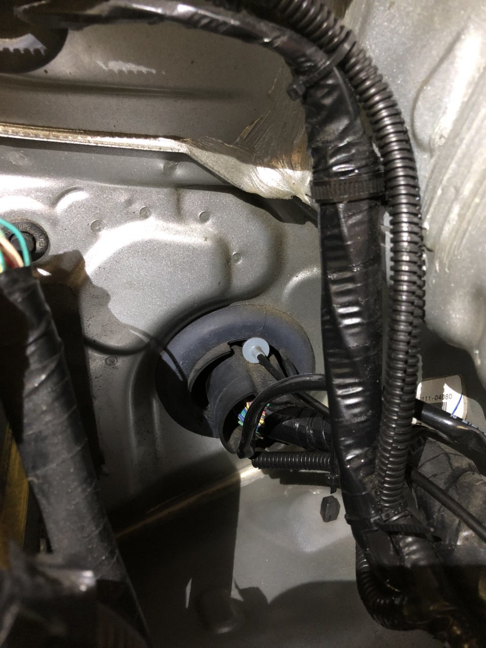

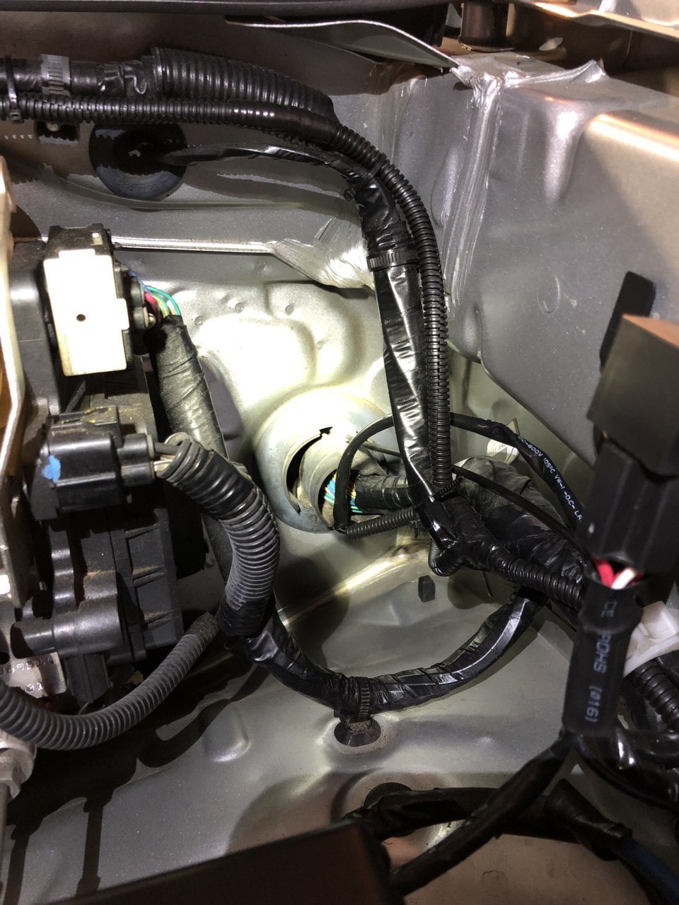

    I’d go the firewall route too. You can poke and fish through the rubber grommet right next to factory harness. Clean and simple no need to remove seats lift carpet ect. I’ve routed my accessory wiring in that spot without any issues and you can’t even see it. Can get you a picture shortly if you want it

    This is just to the right of the brake fluid reservoir and I have 2 sets of accessory harnesses going through it- 1 with smooth shiny wire loom and the other is the corrugated looking loom
