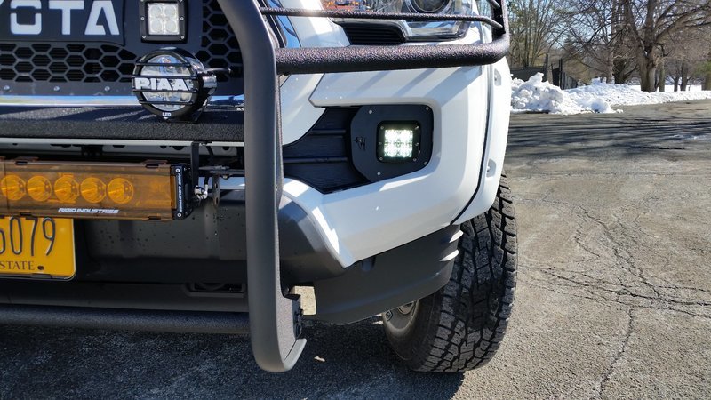

    Get this idea. Buy the lights ,make a appointment at Tintworld go get some doughnuts for the crew and get a coffee for myself and get them installed.20170319_101237.jpg
