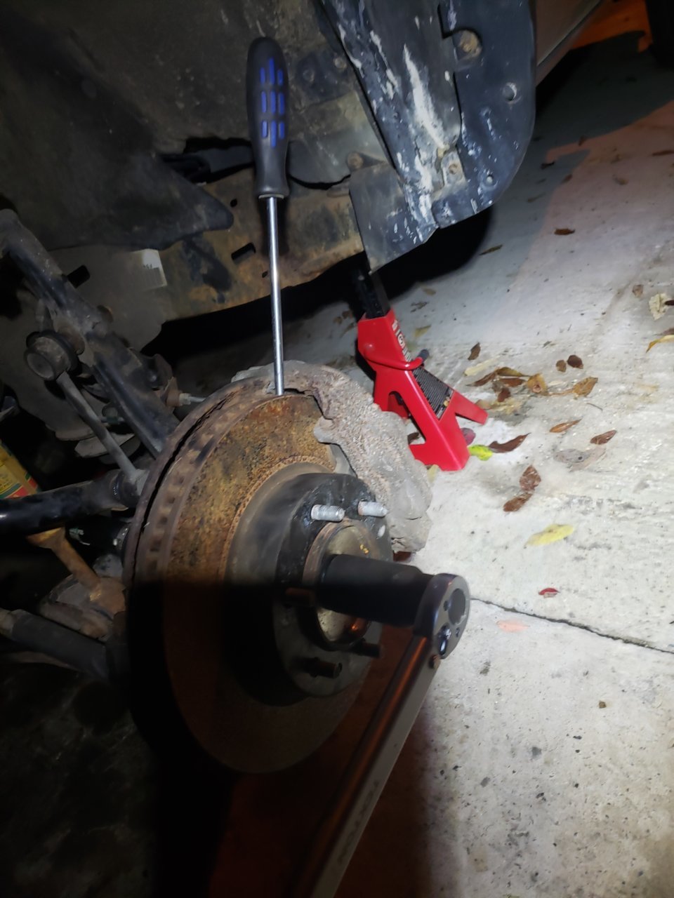

    Another foampile fuckery thread, which is why some people just shouldn’t work on their vehicles.

    let’s have foampile calculate the torque applied at the outer radius of the rotor based on the rotor diameter with 173 ft/lb applied at the axle centerline, and then take that torque value and compare it to the shear force required to break the screwdriver or cause plastic deformation. If there is a small margin to potential damage, I suggest recalculating with a stronger screwdriver with higher shear modulus.

    I’m not a mechanic, I’m a problem solver. Remove the entire spindle and put the CV in a vice and torque it. If it slips in the vice tack weld it. If you don’t like that idea work backwards to the idea with the least resistance.

    The other way to do it is install the wheel leaving the center cap off. Then torque with wheels on the ground.

    I know one guy that uses the differential to do this by locking the opposite side. It's nuts.
    I'm a firm believer in the screwdriver method. I use it on nearly every vehicle.
    I used to use the pry bar method but there's injury risk vs equipment risk.

    1/2 Impact gun. I have lots of other ideas too.

    That worked !!
