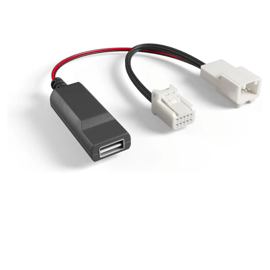

    Old thread, but this is something I'm curious about. Are there any cables out there that would give you the male end to plug into the back of the unit, then split from there to the female usb and a female version of the plug in? I can't find anything. Also, I hope what I said makes sense.
  9. Jan 18, 2025 at 6:24 AM
    #29
    Cr9
    Cr9 Member
    May 27, 2019
    #294525
    23
    Something like this, but with the correct plugs.
