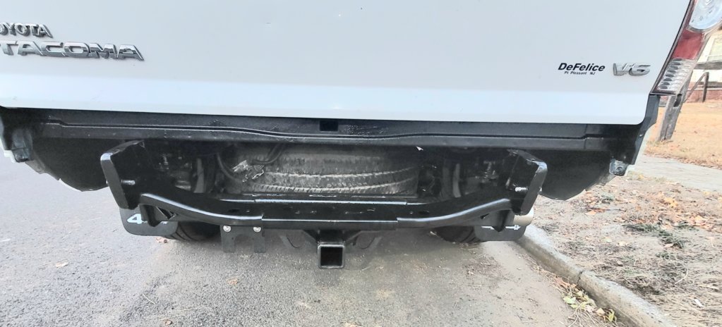

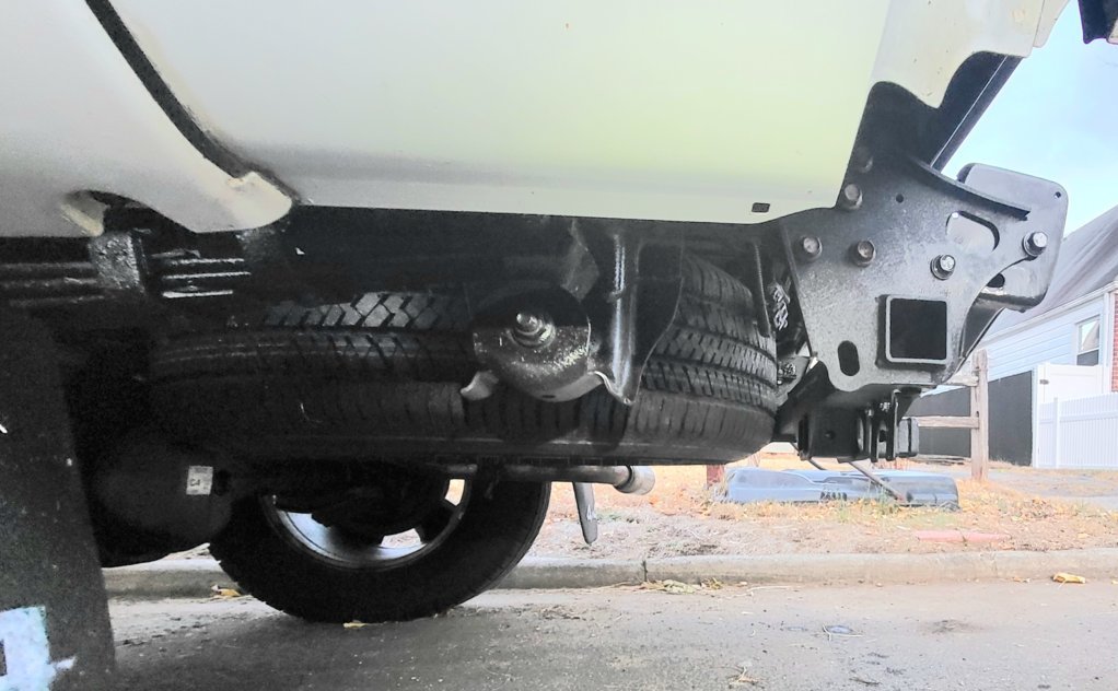

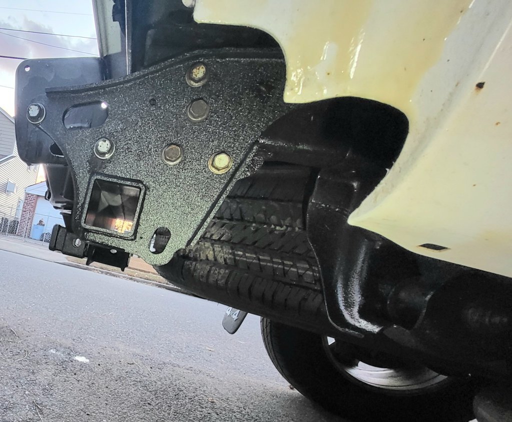

    Replaced the trailer hitch receiver (285$) and the rear bumper reinforcement beam (90$) with all aftermarket parts from ebay. They didn't fit so smoothly initially until I gave them alittle motivation (diddy Lube and rubber mallet and handle bar from my jack). Had to get oem bolts (10.50$ sale for 4 bolts) for reinforcement beam. Was able to salvage and clean the original bolts that fastened the trailer hitch to frame with a wire brush adapter (10$) for my power drill.
