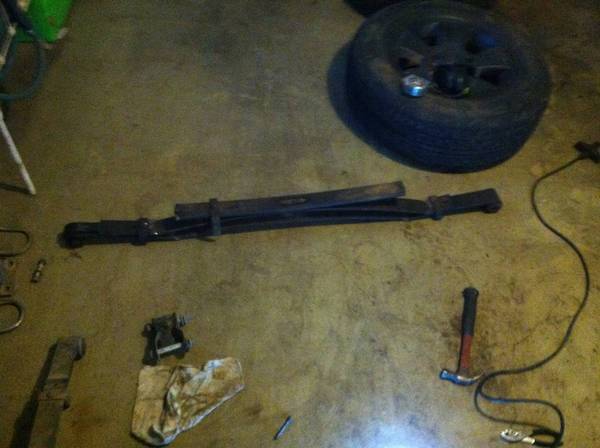

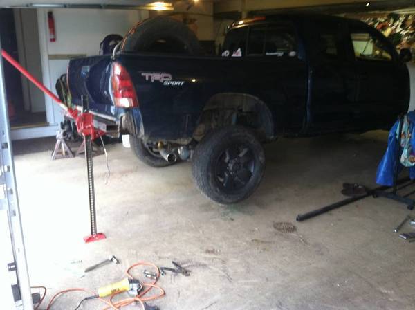

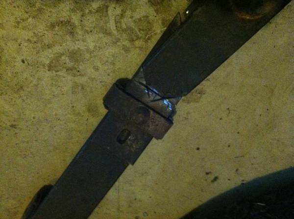

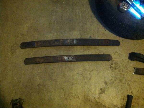

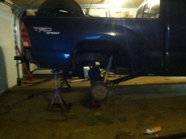

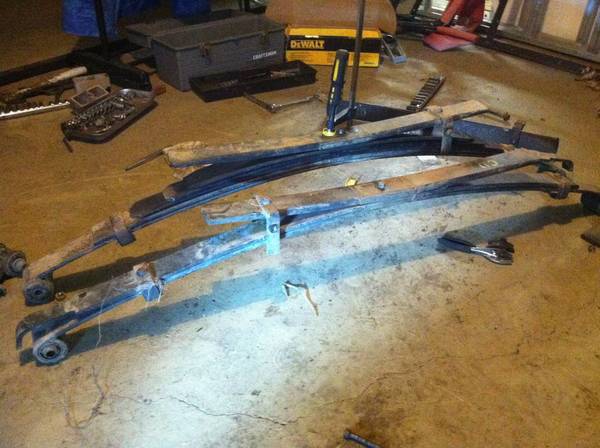

    Custom Rear leaf pack using stock tacoma leaves and ALL
    DISCLAIMER: I'm doing this writeup to show what I did to MY truck and if you chose to copy it for whatever reason, I am in no way reliable for your work.. that being said:
    1. start with a stock leaf pack (this was already cut before I got the pics but you get the idea)
    2. cut off each end of each of the main leaves (I discarded the Overload as I don't wanna run two of those)
    the way in which you ceut the ends of the leaves may not make a difference but I've seen this type of "diamond" cut on many other aftermarket leaf parks as well as the ALL that I threw into this pack so that's how I cut mine
    3. you should end up with two leaves (out of each pack), one shorter than the other
    I measured mine by taking apart my leave pack, setting the ALL on the bottom as I knew it'd be the shortest and dividing the distance between its' end and the end of the next largest leaf then dividing that into three parts, this got me the lengths needed of each of the leaves... if that makes sense
    4. put the whole pack back together (this is a test fit showing the difference between new and old/stock)
    5. re-install on the truck and enjoy
    if my instructions aren't clear, the basic premises was the "chevy leaf swap" that many others have done I just happened to get these packs from a fellow member so they're what I used
    EDIT
    Deleted the ALL as it made the spring rate WAY too stiff.. it was like driving a slammed struck that still somehow sat 3" above stock, not fun!

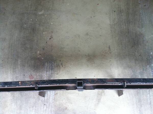

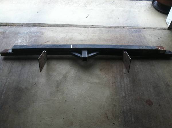

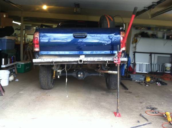

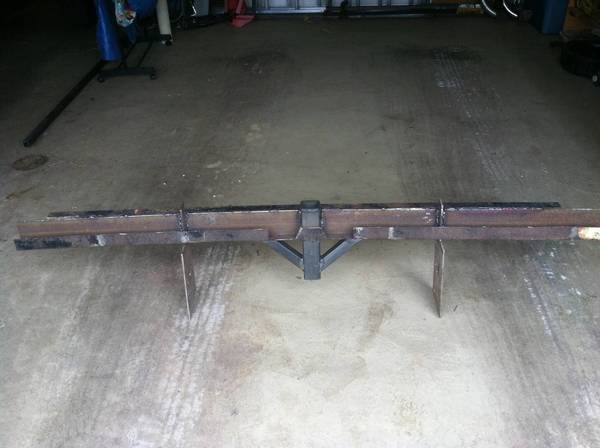

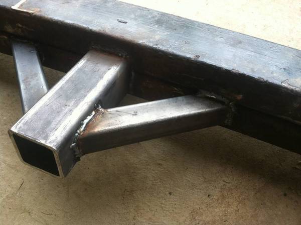

    Rear Bumper Build (work in progress)
    I unfortunately didn't get any pics of the separate parts before the welding got started but the is the basic bumper before I get to do any more work on it:
    the mounting plates will get cut and welded into a 90º to add lateral support
    from under nether currently:
    looking straight from behind:
    shot of my brothers welding:
    (my plan is to learn to weld then finish this build myself but time was critical here and I needed it done)
    stress test:
    yes, it got a little bowed during the welding but hopefully the rest of it that's left to be done will straighten that out, and if not, all it's done is left the corners a tough lower and I'm ok with that
    current state:
    that last pic makes it look very thin but it's actually two sections of 2x4 rectangle welded together, the bottom one is just hard to see.. it'll make more sense once I actually get this thing done :cool:
