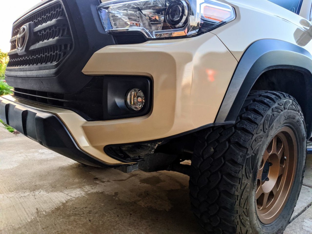

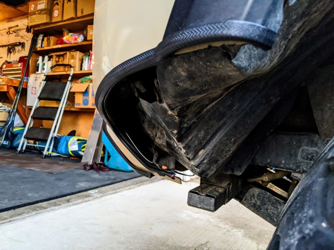

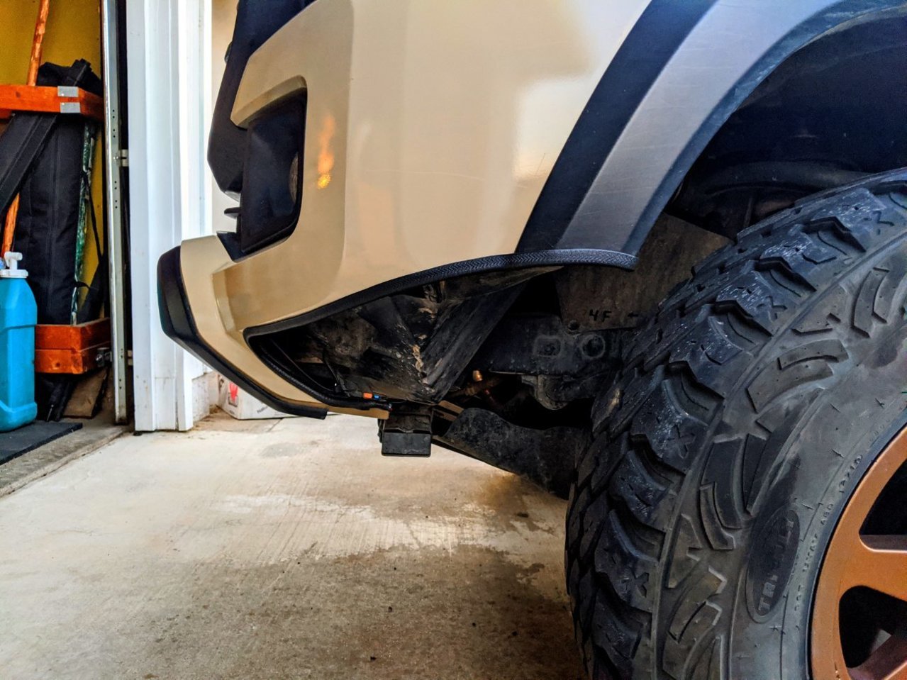

    Like are you planning on doing a viper cut or something? Or is this a cut for an aftermarket front bumper?
    If you're doing a viper, it's really not that hard. I followed this guide and think mine turned out great. I followed the "yellow" pattern. I also used a heat gun to form the fender liner so I didn't need to cut it out.

    Did you just heat the plastic and push up? No need to secure the plastic afterwards?
  7. Aug 19, 2020 at 1:29 PM
    Teegs
    Teegs Well-Known Member
    Nov 9, 2017
    #235568
    455
    I heated it and pushed it up then secured it to the cross bar with a heavy duty zip tie.

    I know this isn't the answer you're looking for but this is the 3rd gen forum. Consider doing the cut yourself. It is scarier than it is hard. If you are planning on using an edge guard on the plastic ( https://www.amazon.com/Support-Moulding-Rubber-Scratch-Protector/dp/B07BFT6GP4/ ) you wont need perfect cuts.
    If you've got your reasons for paying someone to do the job I completely understand. I'm not saying not to. Just saying that this is a job that the layman can accomplish.

    I've seen more bumper cuts f**ked up by offroad shops, than I've seen done by individuals. I've said it before, but no one is going to care about your truck as much as you do. I'd HIGHLY recommend you do it yourself. Take your time, measure 20 times, cut once. As the other poster said, it's more intimidating than it is difficult. However, once you've made the first cut, the rest goes easily enough.

    I'm in agreement with the guys saying "Do it yourself".
    It's very easy to mask off the portion you want to cut with masking tape, and hell, even DRAW the cut on the masking tape you want with sharpie or something. You'll know exactly what the cut is going to look like before performing it. Also, mask and draw both sides at the same time prior to cutting to ensure that they are symmetrical.
    My other real advice is avoid tight changes in direction with your cuts (you may not need to worry about this if you're just cutting for an aftermarket bumper) because the radius of a change in direction can be limited by your cutting tool (dremel in my case). Also, if using a dremel, the plastic will melt a bit while cutting it. Not a big deal, just be aware.
    Finally, put some damn trim on after your done and it'll look great.
