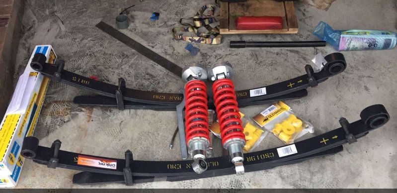

    EastWaTaco
    EastWaTaco [OP] Well-Known Member
    Jun 24, 2015
    #158108
    218
    Angelo
    82 4x4 with a 3rz
    Ome cs019r leaf springs for about 3.5" lift
    extended break lines
    10" billies
    U-bolts
    bilstein/toytec coilovers w/eibach springs
    diff drop
    getting UCAs soon.
    so far its looking like I'll be going to Montana State over in bozeman! the goal is to eventually become an Advanced Registered Nurse Practitioner (ARNP) :thumbsup:

    would you recommend doing so before I install them? I was hoping the heavy bumper, canopy, rooftop tent, and other misc gear would help them.. Also, how exactly do the degree shims help?

    I don't know, you might like it. It was around 4.5in (maybe a bit more) when I had just put it on. Now it is about 3.75-4.00in. These leafs are a fair shade stiffer than the later taco Dakars too so they can really handle a lot of weight even being down a leaf. Your bumper will certainly help and so will the camper shell, I only have a heavy spare tire and a heavy tow package bar. It still won't ride flat even if I take a leaf out which will be nice because I'll ride even loaded down for camping with RTT and all. Shims are nice because they tilt the axle upward a bit and allow the driveline to not be at such a sharp angle. You only need 3 degrees of angle to make a big difference. If you take a leaf out you may be able to use 1 or 2 degrees instead.

    hmm. considering I won't always be running around with all the gear I think I'll pull the leaf. Is it the second one down from the top?

    Just to be clear mine is 3.75-4.00 after a year and a half just settling with all the leafs. I have no clue what the height will be after I pull the leaf, should still be pretty high if my estimations are right though. Toytec recommends removing the third leaf from the top, but I imagine you could play around removing different leafs just make sure you do the final major tightening down of the ubolts once you've found the combo that works for you. Ubolts are a one time use item so you only want to torque them once you've made your mind up.

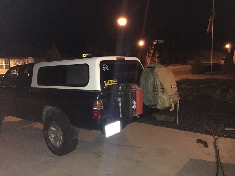

    Still waiting on someone to offer a hand so I can install the lift :(. It should be on within the month... In the mean time I got a trasharoo and moved my
    Lisence plate
    Also still trying to get the energy to paint the canopy. I'm starting to not notice the white as much. Also installing my CB setup soon.

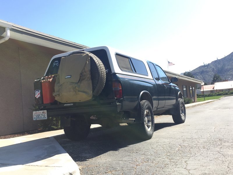

    Just had a bummer night! I was driving up a forest service road bumping along, doing 30 or so when The little latch part broke, where there wasn't any weight, and so the entire swing out swung open really fast and hit the side of my truck. That caused the tire to snap off and the swingout/bearing part to completely snap and come loose. Not really sure where to go from here... I'll probably go without the swingout attached until I figure something out.
