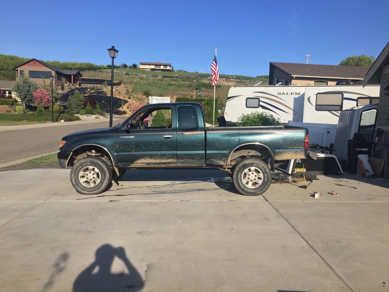

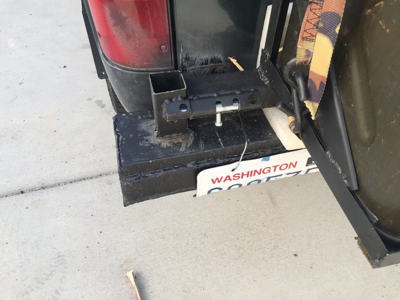

    Bumper hinge snapped again.. Got tired of working on it so I removed the swingout. Went camping the other night and realized how much I love seeing the stars so I took the canopy off as well. Getting tires and rims some time soon. Even with no weight in the back these dakars aren't nearly as bad as everyone makes them out to be.

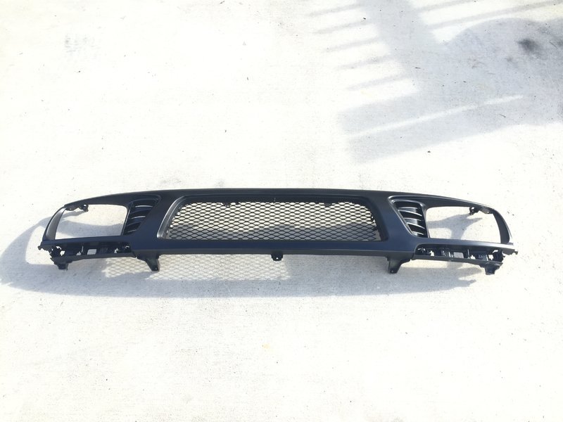

    I have a set of second gen Tacoma badges if you wanna try that on the grille. We should do a trail run sometime!

    You need a clamping style lock, that other thing allows too much play and the extra play combined with a bearing that was never designed for sheer loads causes even more play. Basically a real tire carrier spindle and a clamp handle.

    Might want to look at getting 4x innovations hinge and weld that on.

    Yeah you're probably right. If I get the time and resources I'll chop off the 1" rod I have now, and weld the bar to a hinge built for this kind of load.
    yeah I was looking at those, also comp4x4 sells some. I actually bought a big spindle, but returned it when I thought this bearing system would work better. :annoyed:
