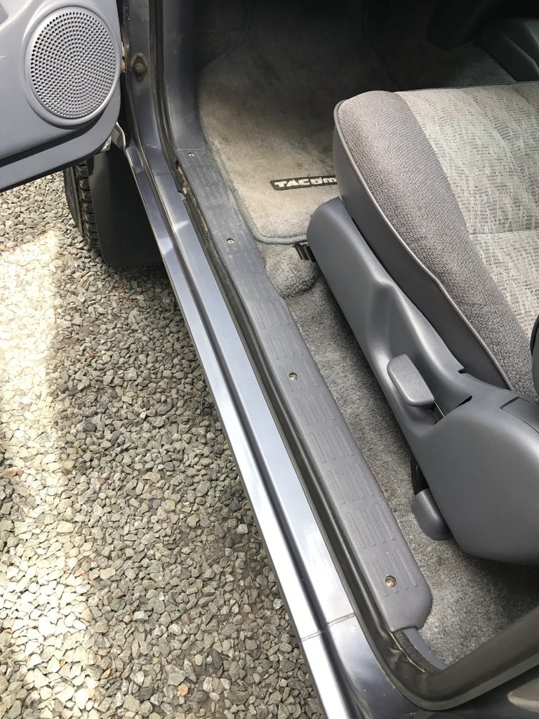

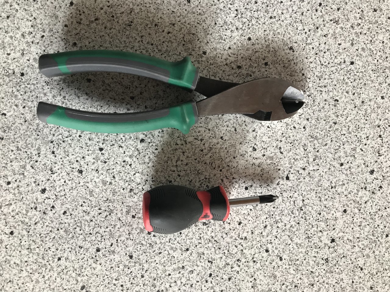

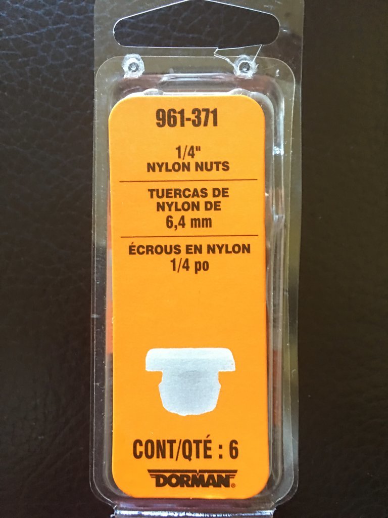

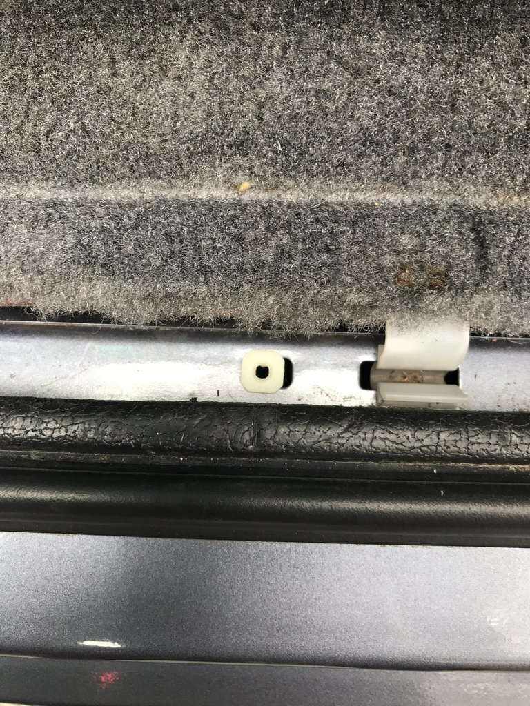

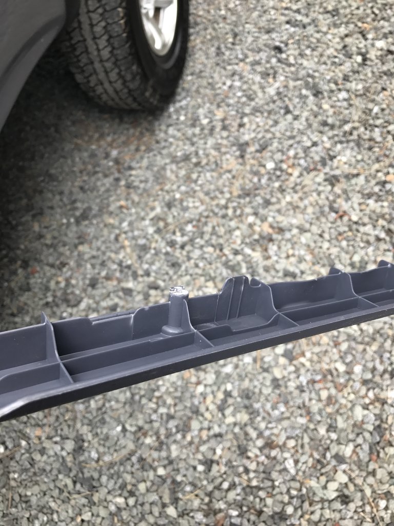

    Not sure if this has been addressed. My door sills have been broken for a while, would never stay securely attached. Couldn't seem to find anything on it. Anyways, cost me $5 works perfect and took 5 minutes to do. Saved me from spending $200 on new sills.
    Tools needed:
    Part from Napa:
    1. Remove door sill (4 screws)
    2. Install nylon nuts:
    3. Cut broken tabs from door sill:
    4. Screw back in (don't over tighten):
    Done fixed

    Great fix to an ancient first gen problem! I don't have a NAPA nearby here, but found the same nuts made by Dorman at a giant online retailer. Here's a pic with the part number:
