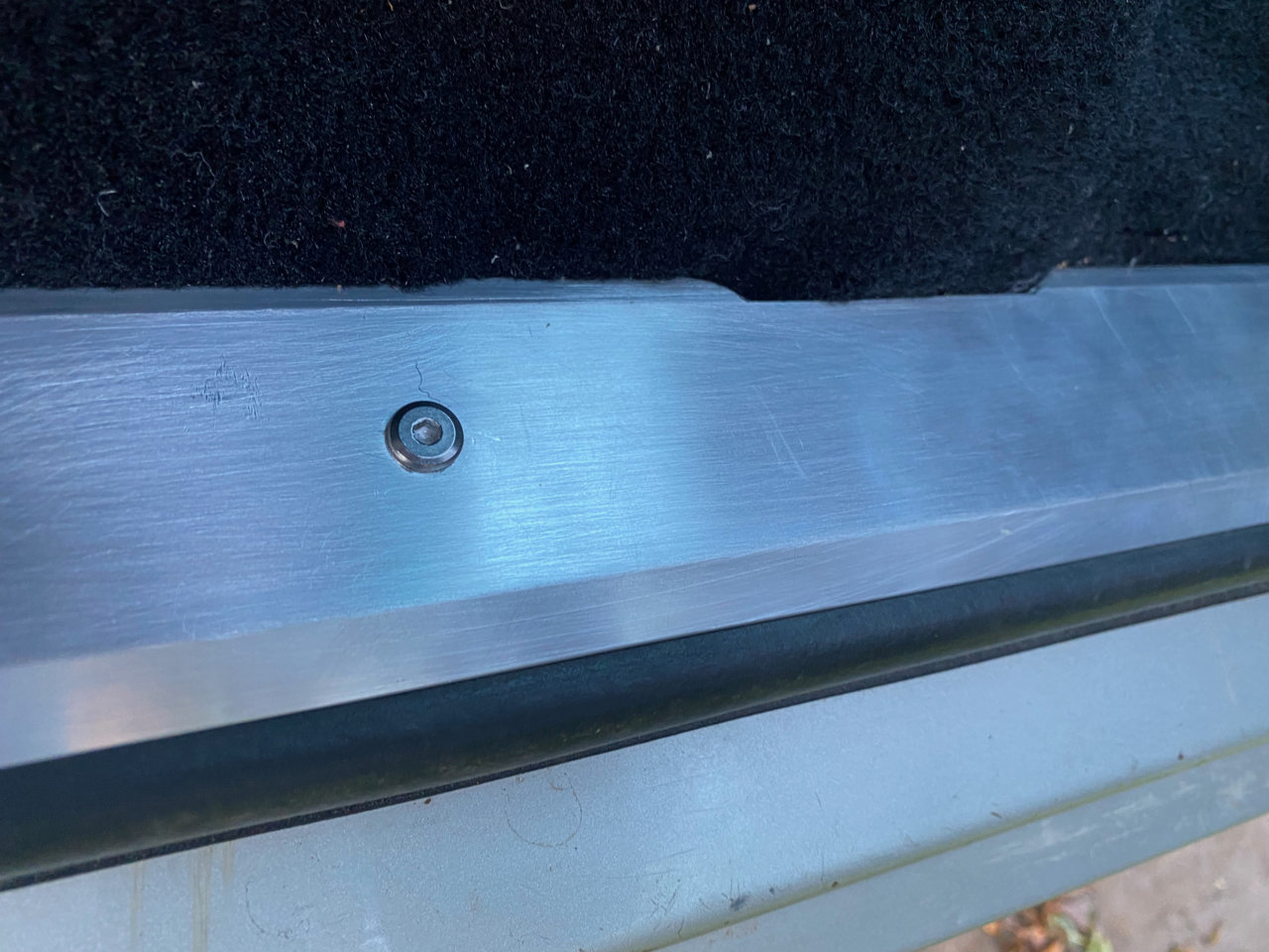

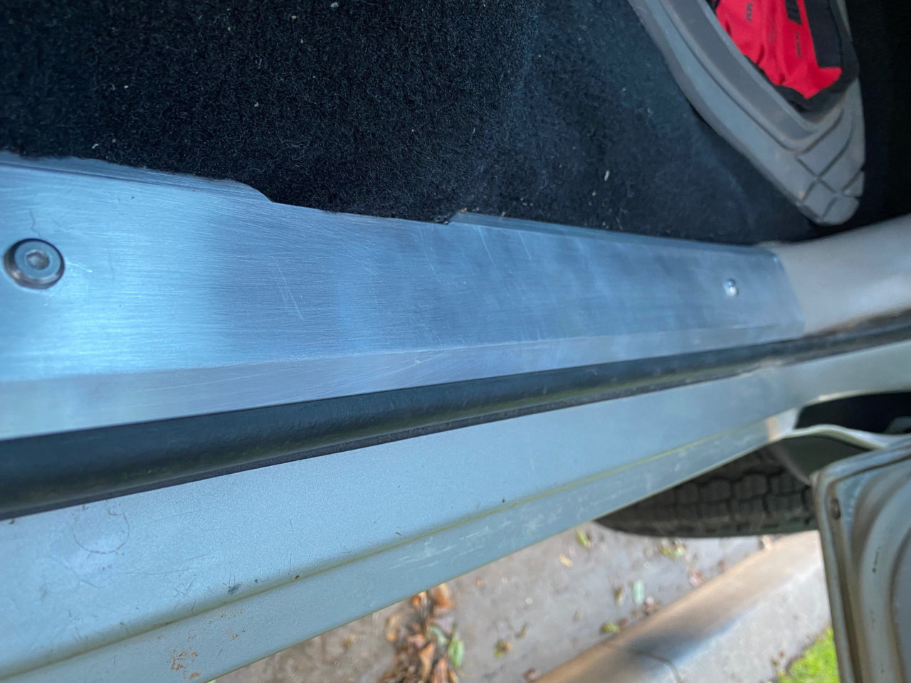

    I did use the OP method but also replaced the whole scuff plate and had to use RivNuts as well.

    Where did you get that scuff plate? I’m liking that way better!
