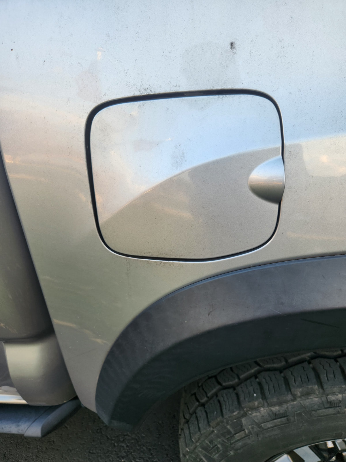

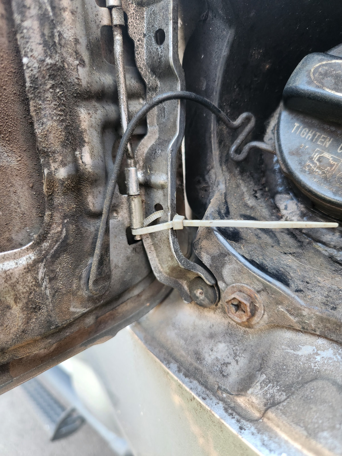

    Been like this for two years. Ten cent zip tie.

    The hinges bind and brake off, how does a cable tie do any thing? But I'll give you an easy answer to the door paint. The new cover is not painted, there are a few tabs that hold the cover on gently pry them up and remove the outer cover. Do the same with the old one put the original back on push the tabs down with your fingers install the new assembly. A little WD 40 once in a while on the hinge does wonders.
