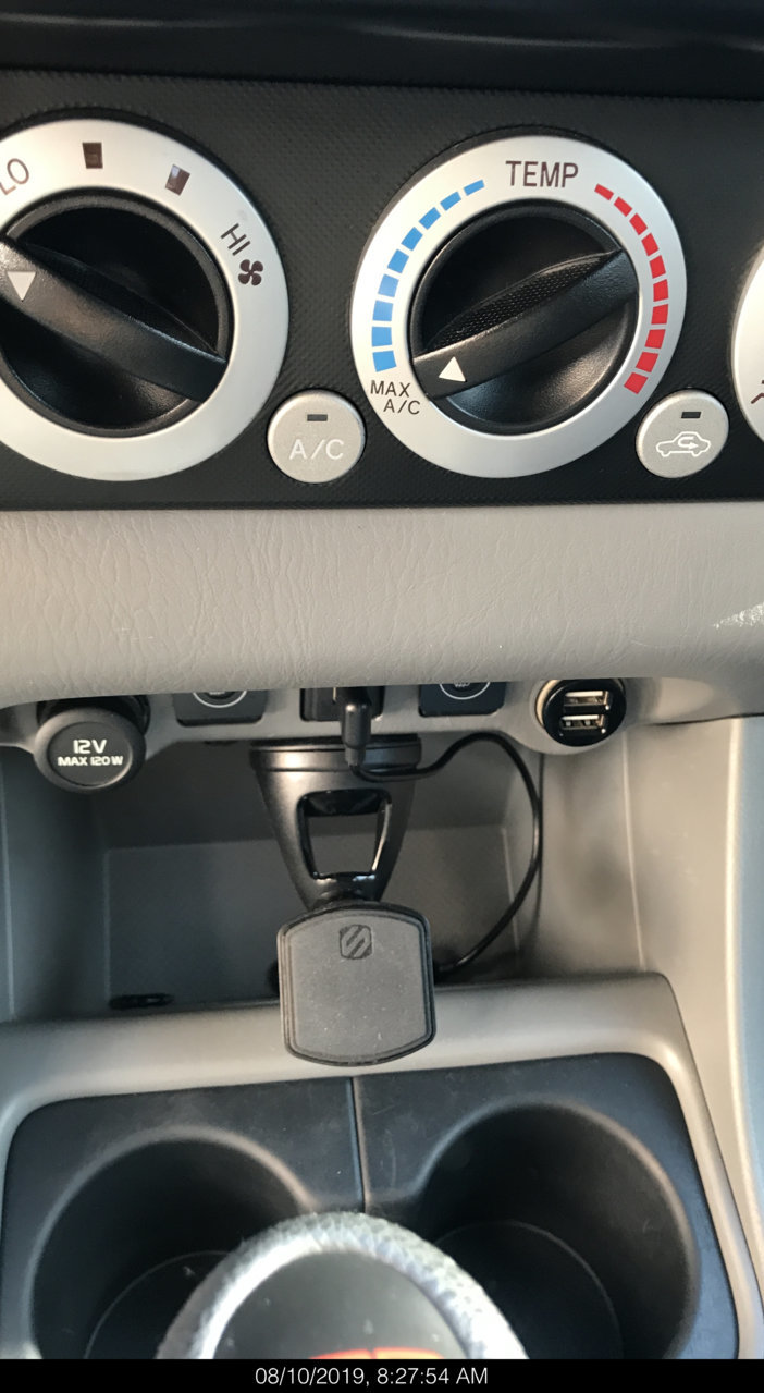

    Doing the seats aren’t that bad. You can slip the heating elements under the seat cover and then pull back the sticky back off and poke the wire through the back.you can run all your electric through the center console . I did the $89 kit from ebay in my father in-laws 2012 and it wasn’t bad. He was nervous that I took the front seats out. Lol . But he loves them and they look stock. I went a different after market route buying a kit from heatyourseat.com a bit more expensive but my seats get way hotter than his. You can kinda see the switches . But i was thinking one of those cushions for my work van417D041A-39CC-4729-A544-6D62C4FB5909.jpg

    You can definitely do it in one day. Make sure you have everything you need and plan out your install. The bottom factory switch blanks are a little PITA to get out but once you have the center console out you can reach under and poke them out.
    https://www.heatyourseat.com/products/vehicles/
    Ive been using this company for almost 10 years. Ive put 5 of these kits in over the years. My family were BIG into jeeps and once i put mine in of course everyone else wants one. And honest truth they get almost to hot! On the high setting. If you do go with them opt for the flat membrane switches. the rockers switches aren’t that good
