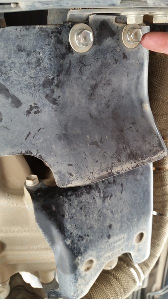

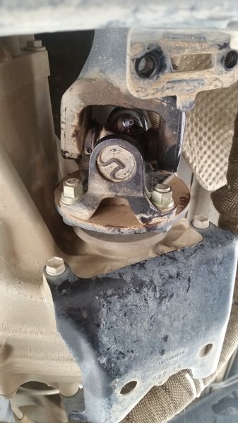

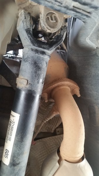

    Few pics... (edit: forgot to mention, this off of a 2012 4x4 double cab.)
    Here is the front of the drive shaft, top of the picture is towards the engine/front end. I was able to spin the shaft by hand to find this little guy, had to clean him good to get a view on him.
    The rear most grease fitting on the front drive shaft is hiding under this little cover. Remove the two bolts seen here. Note again: top of the picture goes towards the engine bay/front end.
    Same deal here, spin the shaft until you can see the grease fitting. Clean it and fill 'er up.
