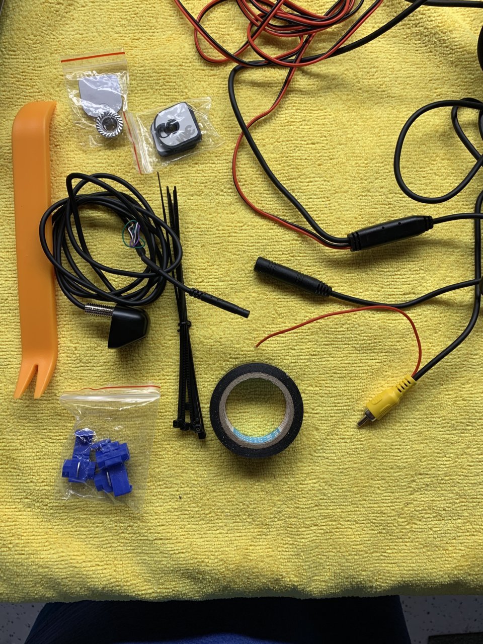

    Both kits comes with all you need, and more. From electrical tape to a tool to remove plastic parts of the dash, it is all there.

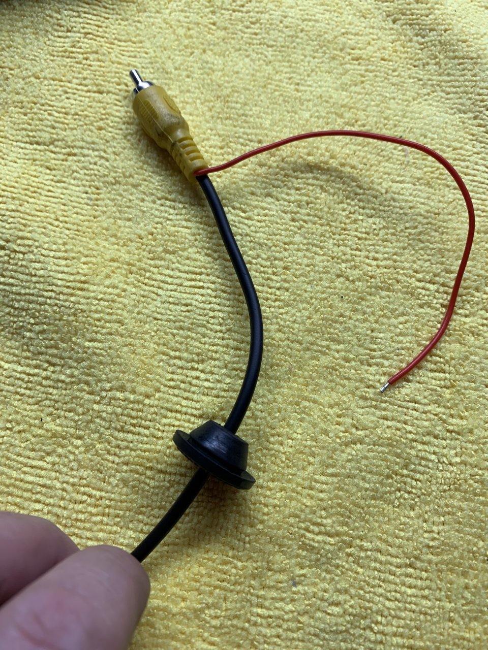

    • Camara:
    Note that you will only need the red power (12 v) that tags along with the yellow video VGA plug.

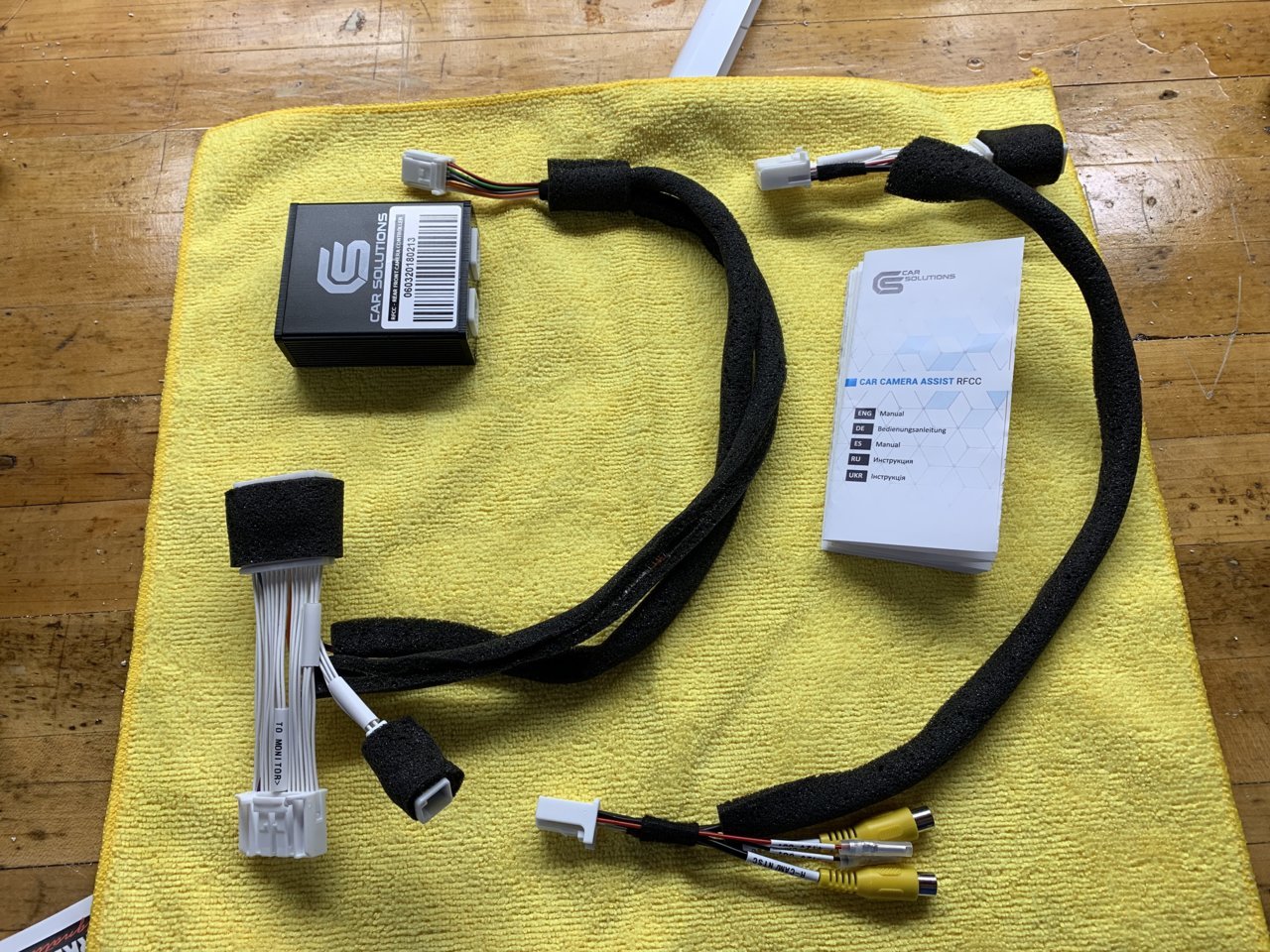

    • -Interface:

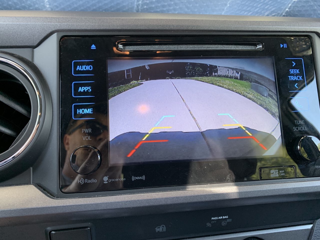

    With this device, you will not need a switch, what I think is pretty cool. You will activate the camera and choose front or rear by using the commands in the wheel.

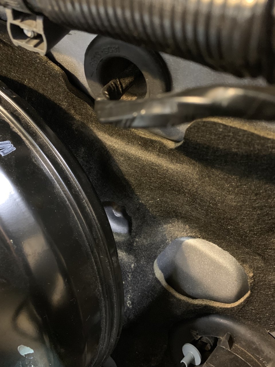

    Step one:
    - Pass the camera cable across the firewall. There is a non used passage with a grommet on the left side, behind the brake booster.
    - I recommend using this as it is unused. If you choose to use any other "passage" watch out for the potential of demaging other cables..

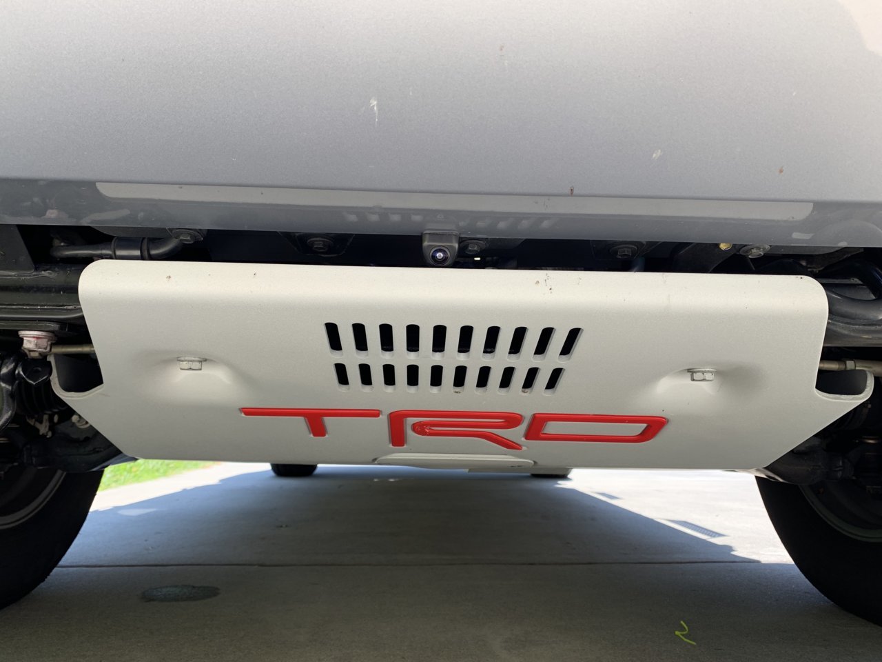

    Find a place for the camera. You can be creative here, but I choose to take advantage of a hole in the front.
    Finally, here is a shot on how it looks like:
