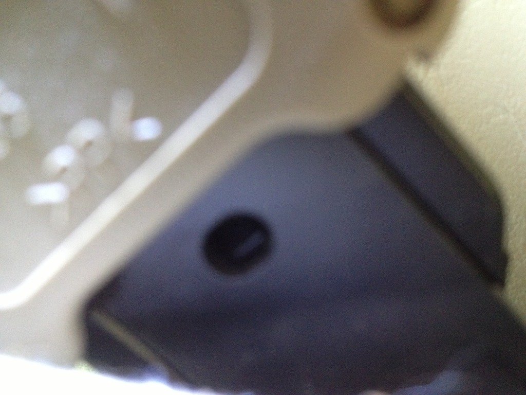

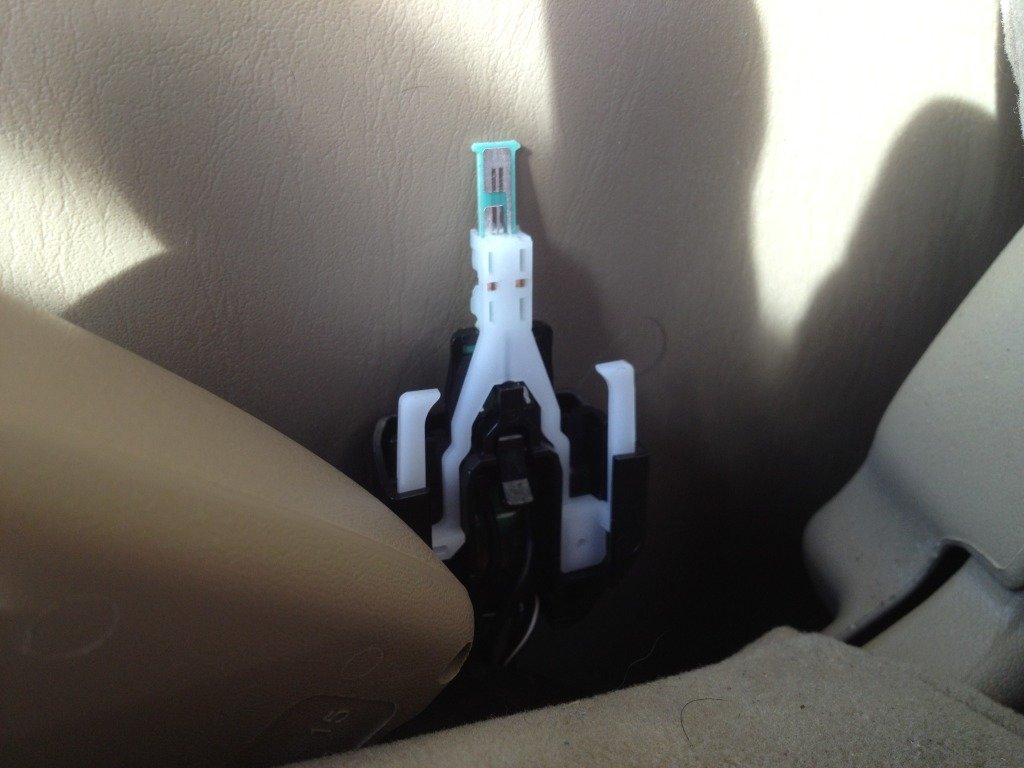

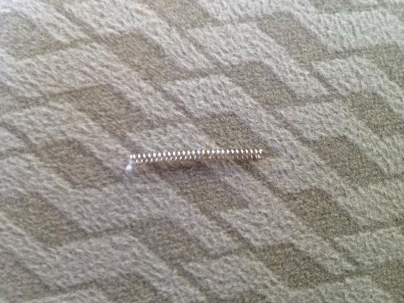

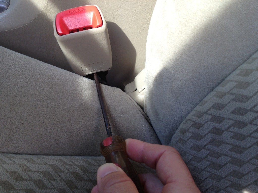

    If you want an easy seatbelt chime/light fix that won't have to be repeated when you remove the battery, this is it.
    On the bottom of your seatbelt there is a hole in the metal.
    Use a screwdriver or Allen wrench to push into the hole.
    Pull the clip down and out to the side. Use a knife or pick to remove the small spring. Use super glue to hold the white piece in the down position. Re-insert it into the buckle until you hear a click.
    Enjoy riding in the truck with the absence of alarms and flashing lights!!!
