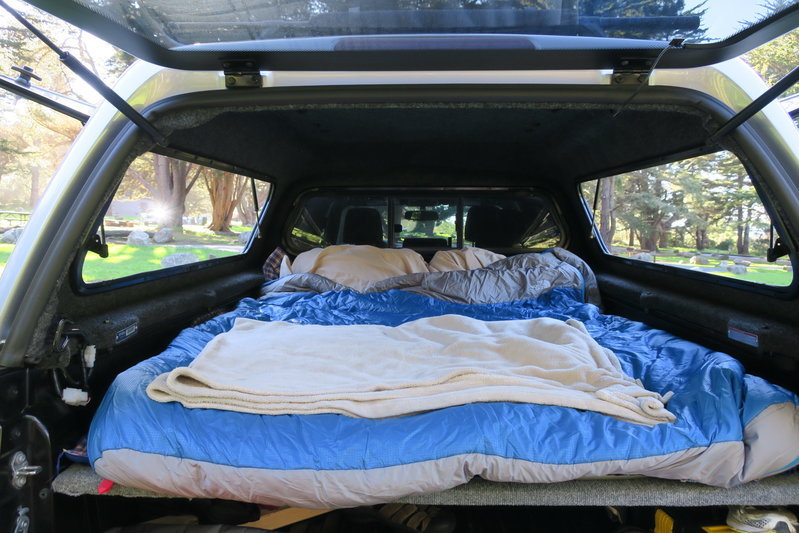

    Tested out my new sleeping platform this weekend and was really pleased with it. Thought I'd share my approach because I've seen some very elaborate, heavy-looking (gas-guzzling) and what I assume expensive sleeping platforms out there. This method is simple, cheap and functional.

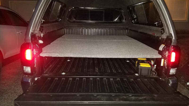

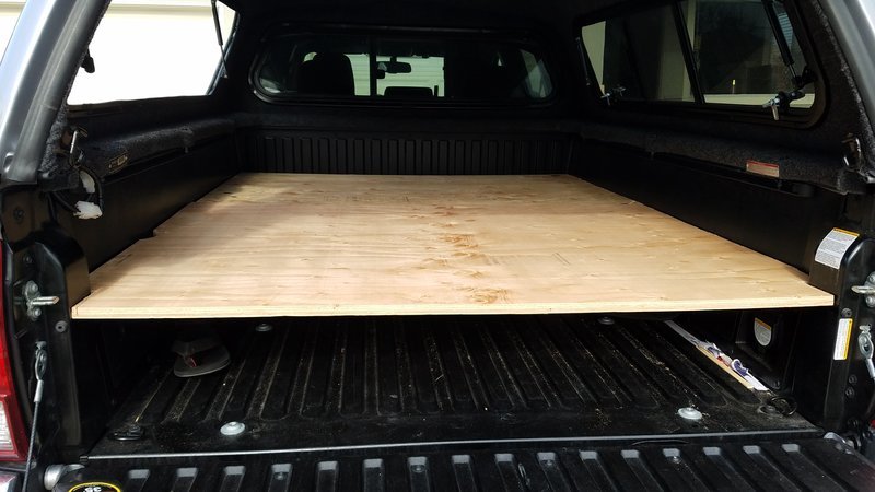

    I went with 3/4" ply, cut in two pieces with the seam spanning the width of the bed instead of running down the length. The panels sit along the lip in the bed liner. This allows you to push both sides towards the front of the bed and give you full height of the bed in back, for coolers, tall shit, etc. To my surprise, the 3/4" ply hardly bowed with maybe 320 lbs on it, so no cross support necessary. This gives an extra inch of space underneath to all the low profile Rubbermaid bins to fit underneath.

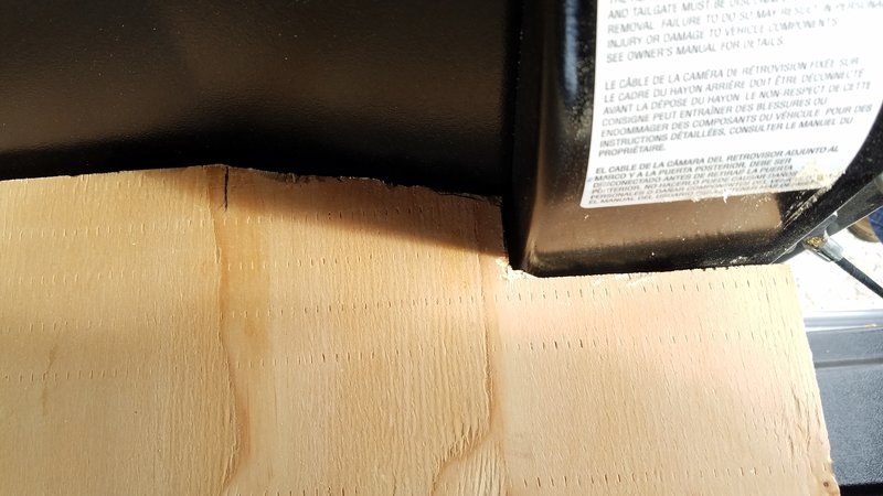

    An important note is that if you cut the ply width wise, you're going to need windoors to get the plywood in there. Sliding in the ply from the back and trying to turn it around to set on the bed grooves will not work if the shell is on. Adding to that, I had to notch out the ply so it could slip over the shell clasps bulging out from the rail (see pic). I also notch out the tail section that tapers and cuts in towards the gate. Pretty straightforward.
    I then covered with indoor/outdoor carpet from home Depot.
    Total cost: $70
    Very comfy.

    Just one sheet of 3/4 inch plywood. Trim side and bottom to get a rectangle the size of the bed (like 60.5"Ă—52.5"....but measure yourself first! And include the inside rail/lip depth in your width). Then cut that in half width-wise. You'll need to hand cut the details near the tailgate to make it fit just right. See my pics.
    Also carpeting adds a little to the size, so err on cutting a hair short instead of long.
