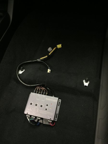

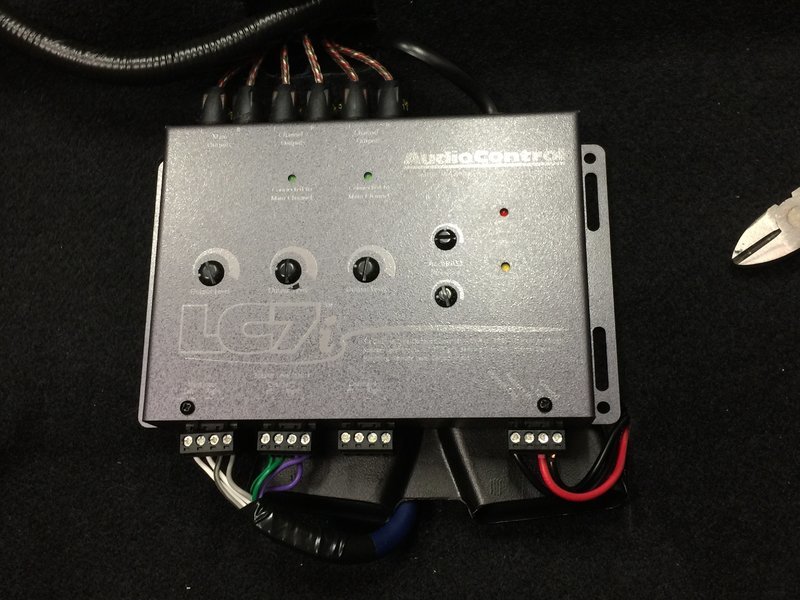

    I see you have RCAs going into your amp... Do you have an aftermarket head unit or do are you using a line converter?
  6. Dec 18, 2016 at 7:18 PM
    #26
    infernotacoluis
    infernotacoluis Well-Known Member
    Sep 1, 2016
    #196140
    79
    luis
    soflo
    2016 tacoma trd off road
    wheels,tire,steep bar,interior light,trd shift knob,led headlight
    use line converter

    I haven't done alot of audio work. Is a line converter pretty much plug in play with the head unit?
  8. Dec 18, 2016 at 9:45 PM
    #28
    SlowComa666
    SlowComa666 Well-Known Member
    Nov 3, 2012
    #90408
    395
    San Antonio TX
    2014 SR5 Access Cab 2WD
    not normally. they might make a harness now but you would still need to connect/solder the speaker wires to the LOC. also run power, ground, and turn on to it

    Yeah lc7i under the passenger seat.
    No soldering needed to connect the unit. I did solder the connections in the metra head unit harness and speedwire though. Speedwire run the head unit to the lc7i. RCA out to the amp. Not that difficult just a pain to run all the wiring.
