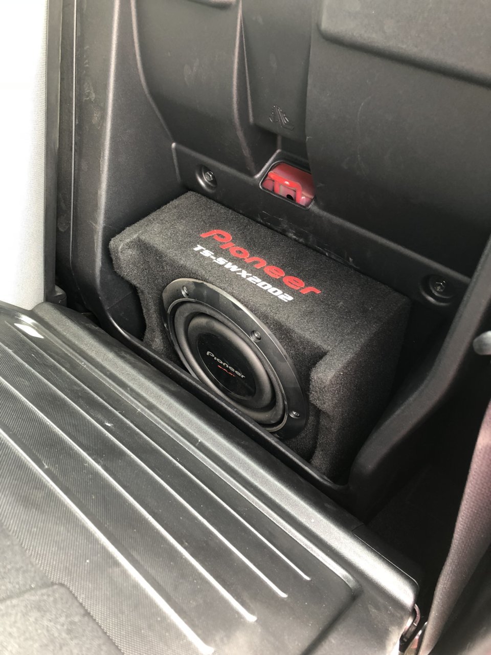

    Ok last post for a minute I swear. I’ve also been looking for an easy but inexpensive sub solution for my 16 DC. I keep coming across these:
    https://www.amazon.com/Pioneer-TS-SWX2002-Shallow-Mount-Pre-Loaded-Enclosure/dp/B01FR5HDZ2
    And I was able to test fit one today that I found at a local shop:
    It fits perfect, just drops in the bin and the seat latches no problem.
    I’m planning on ordering one to start, and adding a second if I decide I need more, and putting both behind the passenger seats. Hell maybe even three eventually!
    Would you guys aim the sub towards the seat or the cab wall? I’m thinking cab wall so I don’t have to use a grill or trim the panel...

    I do think 2 boxes would fit...one on each side would work. Loud enough...well for me it is plenty loud I listen to a lot of old drum & bass and other jungle edm music. The 10" hits hard in the cab...bass doesnt travel like crazy outside of cab which is what I wanted.

    I left mine front facing and stuffed little foam wedges between the speaker and that plastic lip...the sub would make this clipping sound when it hard and it was because the woofer was extending far enough to hit the plastic lip.

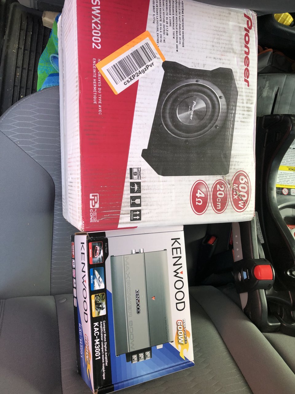

    Parts arrived, mostly Amazon and eBay specials. Sub was $77 shipped on Prime, amp was on eBay for $88 shipped, and I found a kicker ck8 wiring kit new in box for $40 shipped. I also got an “add an amp” wiring kit from eBay for $20. Once I add some speaker wire to go from the amp to the sub I’ll be all-in at about $230.
    The amp is rated at 200w rms at 4 ohm and 300w rms at 2 ohm, so if I decide to add more bass later I can just run a second 8” in parallel and still have enough power. If I still need more, a third sub would fit but I’d want a 1 ohm stable mono amp to power it.
    I also got a set of Subaru tweeters for my birthday last week and they have helped tremendously on the mids and highs. I also managed to get them on sale for $77 so my overall upgrade cost is right at $300, would have been closer to $400 at full retail. Hoping to get the sub and amp installed this weekend.
