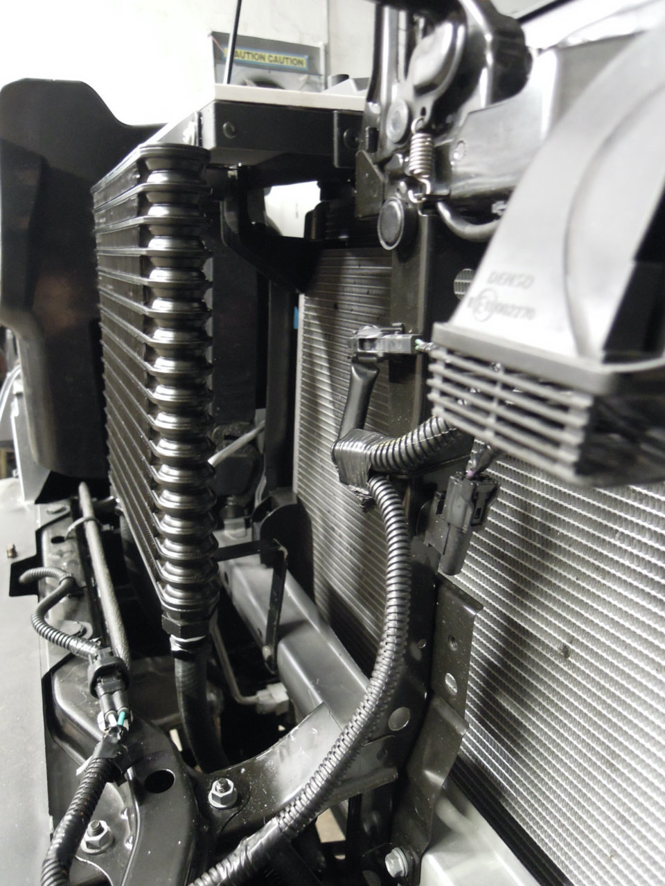

    So much room to add an external cooler to the mix for towing. Took my time and did a nice clean job keeping it a bit closer to the grill. Tapped into the outlet side of the Radiator Cooler then back to the transmission. No extra holes drilled into the truck - just one 3/16" through the grill support. Took an extra 19 oz. of fluid. Very happy with the results.

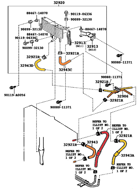

    Obviously substitute the OEM for the DERALE®:burp:

    Hi For now I chose to leave the Rad. cooler in the loop. As I see it, the lower hose is the exit or cool hose. Followed that to the passenger side and pulled the line - and routed it to the new cooler then from the new cooler right to the remaining connection. It was easy with the 3/8" hose that came with the cooler. I do plan to change it out to metal lines in a couple of weeks with just short rubber line connects. We shall see.

    I don't think 21's have PN 32906, so he tapped off the rad.
