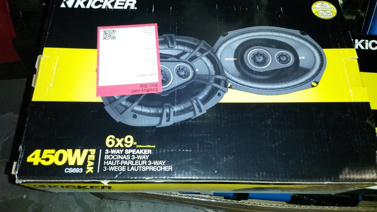

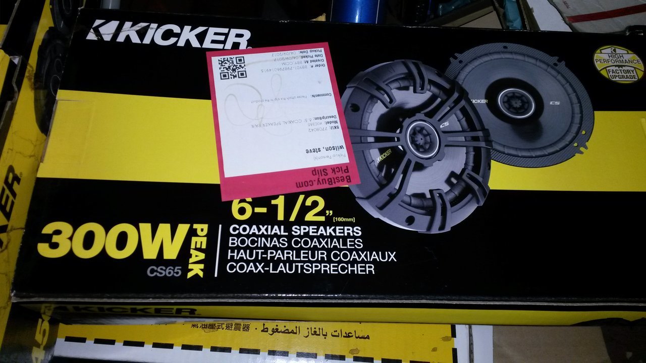

    Installed these front speakers over the weekend - massive improvement in clarity, mid, and treble and while bass isn't as loud it is much clearer and less muddy. I think one of the things I like most is that with the factory speakers i felt like I had to crank it to near max to actually hear most of the sound spectrum. With these I can have it at 1/3 volume and have great clarity. That said, i'm actually amazed after seeing the factory speakers that they could put out as much as they did. They weigh as much as a small piece of cardboard and feel like they are made of the same. Pretty remarkable they could get any sound at all out of those paper-thin things!
    Unfortunately while forcing the mounts (those mounts don't like up right and require some add'l drilling) I slipped and punctured one of my rears.
    Amazing customer service though - I called Crutchfield this morning, primarily hoping I could still get a replacement pair for the 1/2 off I bought those for. Honestly explained what happened - I was clumsy and punctured a new speaker. Without hesitation, the representative is overnighting me a new set and label to return the others free of charge. Service has gotten so bad in so many areas I just don't know what to do with myself when I get GOOD service and that's spectacular.
    Thanks again for the tips... very nice sound for not a lot of money. And I was indeed surprised to hear the increase in volume output with an aftermarket set of speakers on a factory head unit! Last couple of times I've done this, buying a set of speakers leads to buying an amp which leads to buying a sub, etc., and I'm confident that once I get the rears installed I'll be very happy with the full setup.

    I won't need to add a sub - especially once I get the rears replaced. the only challenges I had were:
    1. Assuming the speaker mounts (front) were the same for both sides. I ended up having to take them both off their mounts and remount to the other so the holes on the mounts would line up properly with the holes in the door.
    2. The holes on the mounts don't entirely line up - I had to drill a couple of additional pilot holes to make them work, but it worked and they mounted snugly once that was done.
    Otherwise not too bad. Taking the doors apart was the scary part, but if you follow those OEM+ Audio videos linked on this thread it's pretty easy. I could pull them apart again in less than 2 mins now
