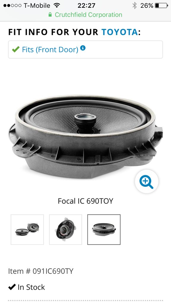

    Just curious if anyone here has added the focal 690toy's to the kicker tweeters looks like another plug and play option according to crutchfield for the front door, they are pricey but still remember trimming my door panels drove me crazy on my 1st gen, and like to keep everything intact if possible. Or if it's even worth it

    Whatever you put in the front and rear doors will still require speaker mounts but no trimming at all.

    IMG_1932.jpg By the looks of it I was figuring it was built in
