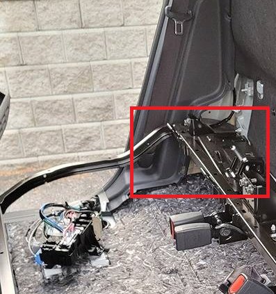

    Behind rear passenger's panel corner.

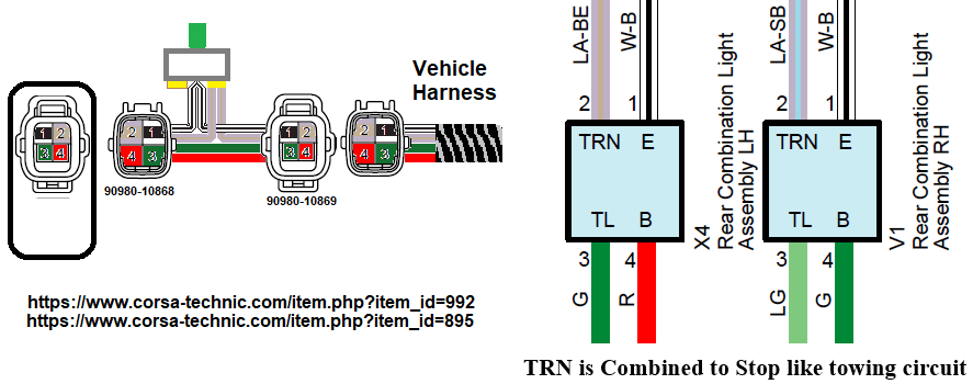

    Hi Puppypunter, No i don't have a clue where that plug is but out of all the sujestions this looks like the best solution. I will try to find it and see if my limited electrical ability can get it done. I really appreciate your fast response. Merry Christmas and a Happy New Year to you!

    Thanks I will start looking there first!

    So only upside is no need to drop headliner???

    The easiest thing would be to see if Smartcap would sell the connector.

    What connector would that be?o_O

    Yeah, I guess ease of install trumps cheapness...but I'd de-pin that connector before making such a large hole.:eek:

    First I would like to Thank the members here for their response and help they gave me so that eventually I will get this solved. It's in the middle of hunting season and the solution looks like it's going to take more time than I am willing to give at this time. With your help I have found the towing converter but it looks like I will have to remove the rear seats and maybe the junk box that is under the seats to get to the wireing and towing converter as my hands are to big to get through the little window that they provide to get to everything.
