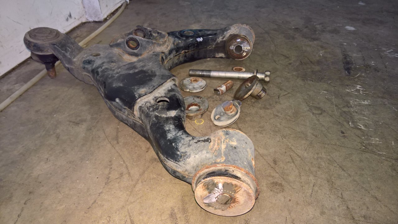

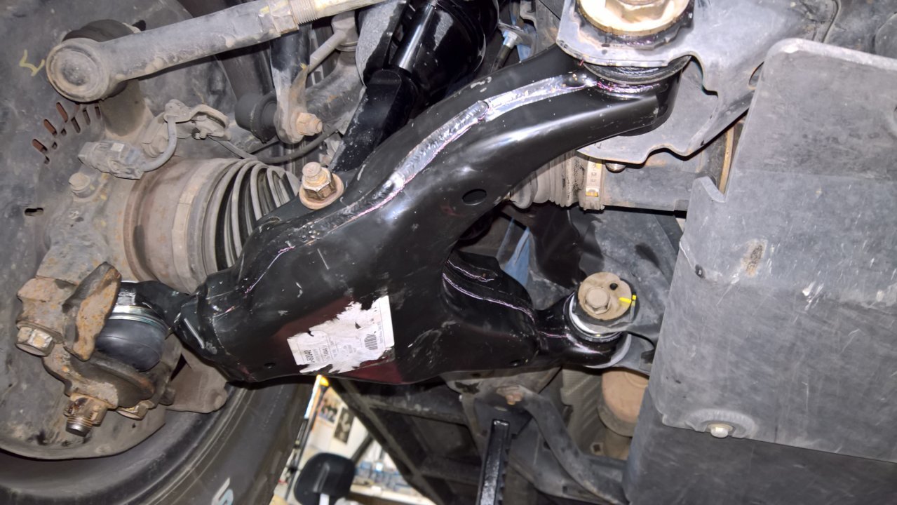

    This is the most recent set of LCA's I cut out. Came off of a T4R from Maryland. You can see in the first pic where I cut, and in the second pic you can see where I marked the alignment cams to the frame.
